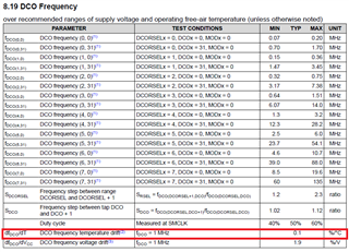

We have a question about MSP430's default CPU clock frequency.
In TI RTOS, the default CPU clock frequency is 8192000 (MCLK=SMCLK=819200).
Can we adjust this frequency by external circuit?
Can MSP430 calibrate this frequency internally? we would like to know tolerance of this frequency.

  • Hi Urica,
    According to the MSP430F552x datasheet, the DCO frequency temperature drift is 0.1%/C
    How to do the calibration for MSP430F552x DCO?
    Henry
  • Hi Henry,
    You can find this information in the device family User's Guide https://www.ti.com/lit/slau208, specifically section 5.2.6 "Digitally Controlled Oscillator (DCO)" and section 5.2.6.1 "Adjusting DCO Frequency".
    Resource Explorer also has several code examples that show how to calibrate the DCO [link], specifically the MSP430F55xx_USC code examples.
