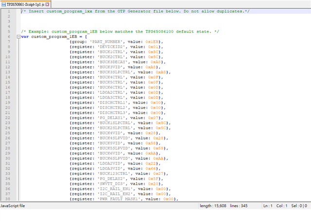

Updated the Programming Script File to TPS650861-Script-1p0.js file.
Then performed to program the device using IPG-UI EVM GUI by MSP-EXP430F5529LP+BOOSTXL-TPS650861 in section 4.4 Step 5. The IPG-UI reports show "Hardware NOT Connected" as below
