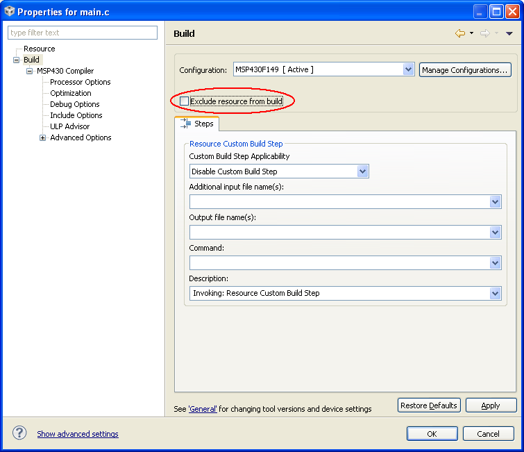

Hi Andrea,
Andrea Bioli said:So I played a little, and I discovered a crazy thing: if I move all the interrupt handlers on certain source files, they all get compiled and linked, but if I move them on other files, they don't go in the final executable, resulting in the warning as in subj.
The only thing I can think of is of different compiler settings on different source files, even if I created them with CCS and I didn't touch anything so specific.
Could it be that the files get excluded from the project? You can check by right clicking at the file, and click on "Properties":
Thanks for the shot, Leo, but no way! :-(
