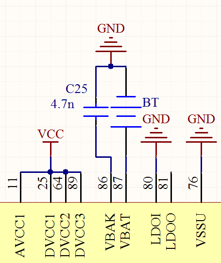

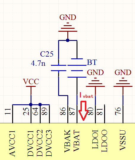

Here is a part of my schematic.When the primary supply is off, there is about 0.7uA ( Ivbat )from the battery,such as the user's guide discribe.When the primary supply is on,the Ivbat dose't turn down to 0, but up to about 22uA. And then I set the BAKDIS bit in the BAKCTL register to disable the battery backup system, the current ( about 22uA ) is still existsing.22uA it is to large for a backup battery.How can i fix it ?
Hmmm, in this circuit, there shouldn't be any current when the device runs from primary supply. The only situation where I could imagine some current is when the battery voltage exceeds the supply voltage while the device is active. In this case, it could be that some cross current flows from battery to supply. I agree, it shouldn't, but that's the only idea I have.
