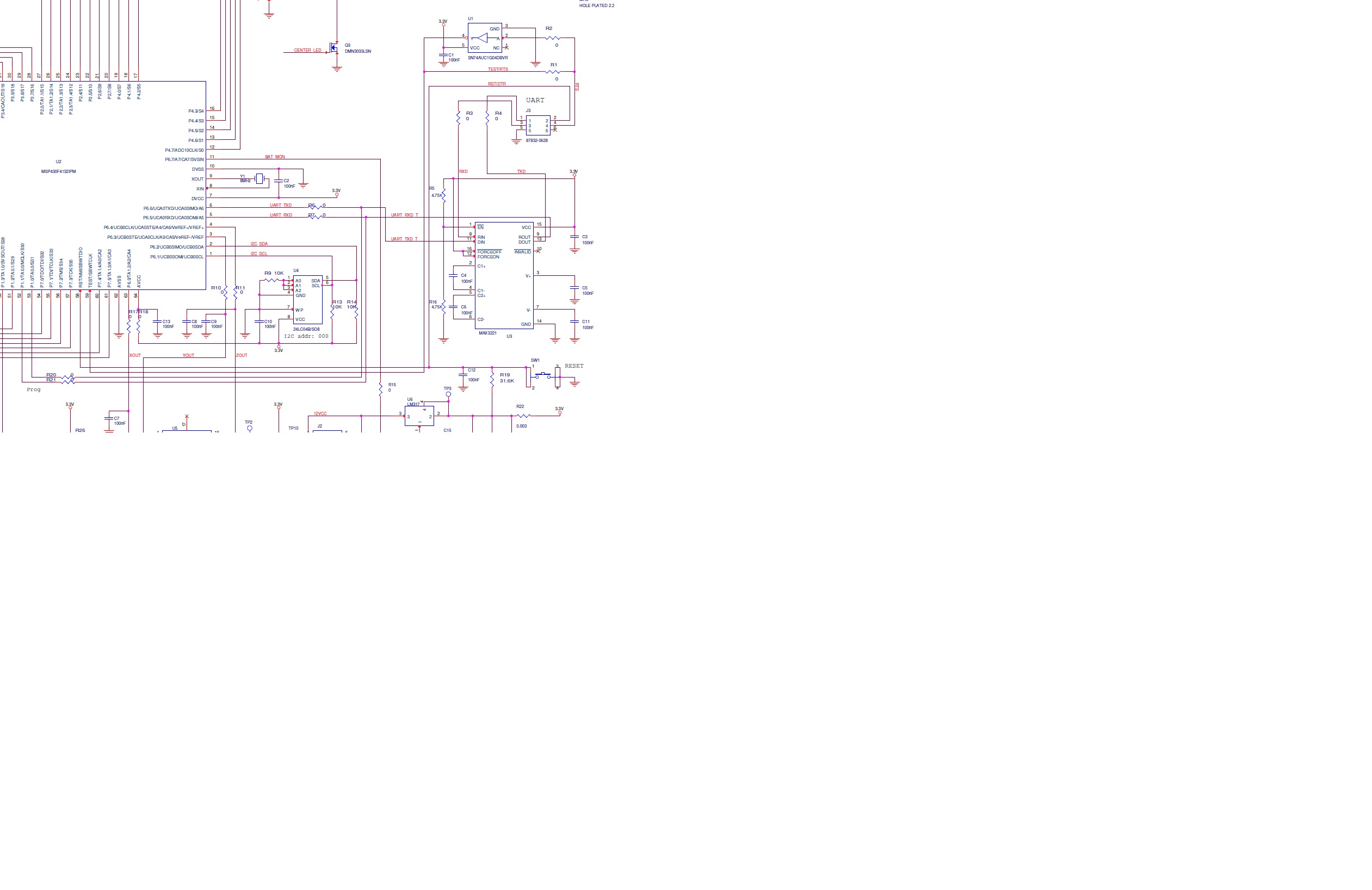

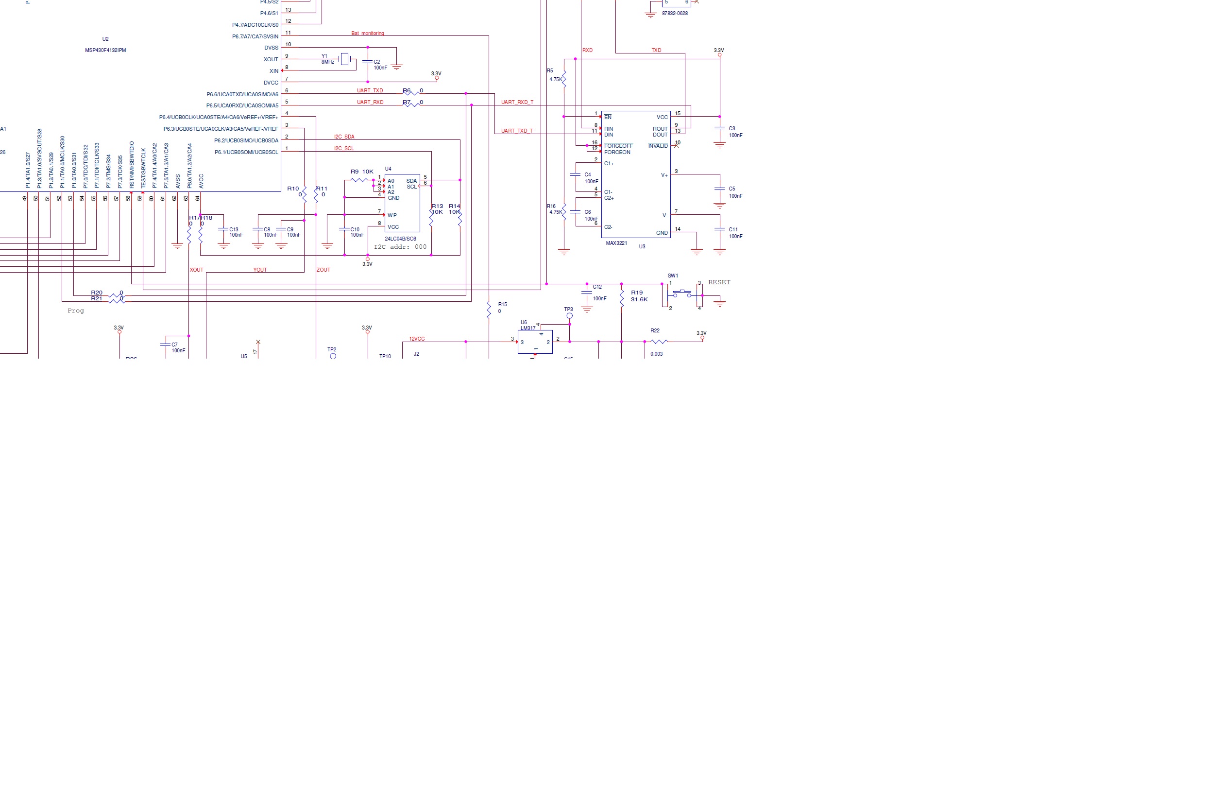

    - I am using my own design. It is pretty simple, based on the reference design posted on TI site. nothing fancy.
    - The design is powered by its own power supply 3.3V. The BSL tool is powered by its own power supply. The two boards share the GND, TXD, TEST/DTR and RST.NMI signals. TEST is inverted as per SLAU319G.

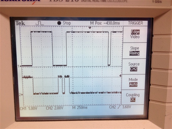

    scope shots- which I can send I necessary show the correct BSL sequence at the MSP430 pins. All voltage levels are correct. (as said I used this setup with an older F1121 device successfully so I'm really suspecting the SW at this point.
    - TXD seem to blip one or two pulses- I will confirm later- so the processor is clearly alive yet I get the no sync error

    it looks I'm out of luck. I get the same error using the files you sent. However it appears that my sequence is correct. I have scope shots I can send along if someone can  take a look at them.
    It appears that as soon as the TEST sequence ends, the processor responds on TXD with a 1s high pulse, then TEST responds with another low pulse then high again. Does someone have a waveform that shows what happens after the processor has accepted or not accepted the entry sequence? How is it supposed to respond? on TXD, how many pulses etc.

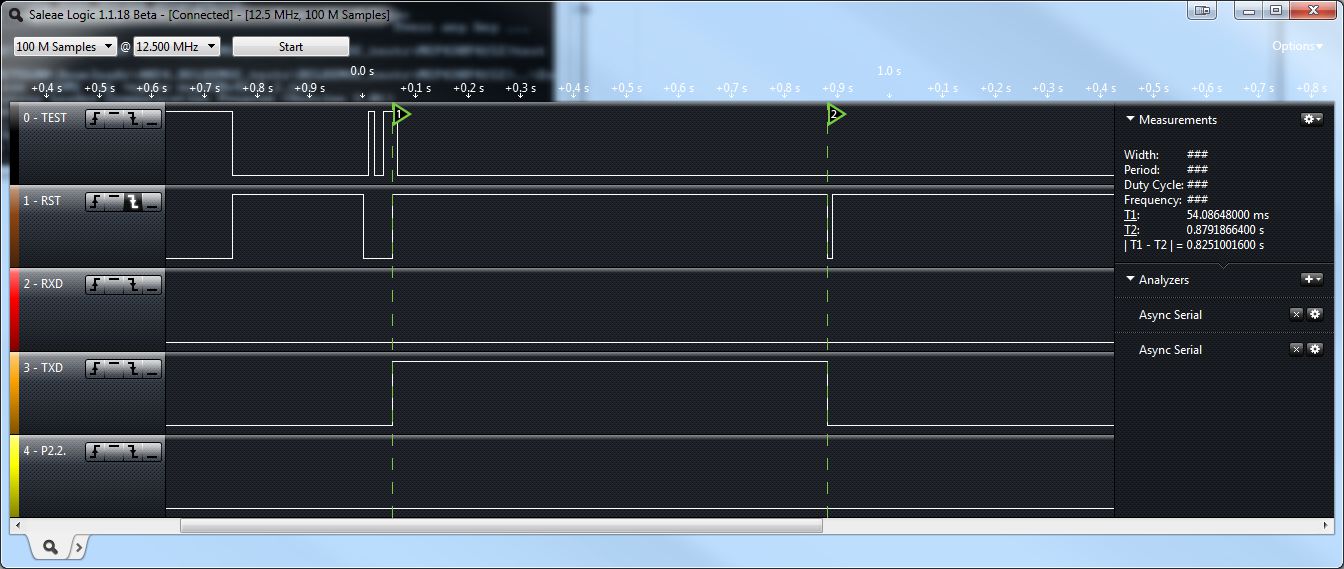

    Do you have any application code running on the device (i.e. LED toggle)? Does the application start after the entry sequence?
    Please send us the screenshots if you can, including TEST, RESET, TXD and RXD.
    I don't think the MCU will toggle the TEST pin since this is an input for the MSP430. Is your host driving the pin actively or is it floating after the entry sequence?
    TXD will be set as output high instead of Hi-Z input (default state after reset), but the device won't respond or toggle the pin, unless it detects something on RXD.
    Is RXD set as output high by the Host circuitry?

    - screenshots attached. First one is the TEST(CH2) and RST(CH1) sequence. The second is the TXD(ch2) vs TEST(ch1) sequence showing that the processor responds via TXD after sending the BSL sequence. I did not say the MCU toggles the TEST but the TXD rather. TXD is an output from MCU. It is true that there was no pulse on RXD at all at all this time. Schematic attached. Note that R1 is not populated in the schematic and both TEST and RST signals are fed from an USB to RS232 cable via a double set of 7V tolerant inverters circuit that is powered separately by a 3.3V supply. the schematic and this circuit share the ground.

    The only problem I see in the screenshots is that glitch on RST. What is causing that? Does the same happen if you try checking the output from USB->RS232 disconnected from MSP430?
    Now, I ran some tests using the circuitry found in SLAU319 and got the following:
    - Good entry sequence. Note that the entry sequence is similar to yours and TXD is pulled high as soon as the MSP430 goes to BSL (just like your case), but the host sends the first packet after ~260ms.
    - Then I tried disconnecting RXD/TXD from MSP430. So the MSP430 detects the entry sequence but the host doesn't detect the device:
    Same happens if I connect RXD, so the MSP430 detects the host but the host doesn't receives the response from MSP430:
    This seems to indicate to me that your host is not receiving a response from MSP430, but I'm not sure if the MSP430 is receiving the ACK from the host.
    If you are not seeing anything on RXD, it could mean that this circuitry is not working.
    Have you tried sending data to the MSP430 using Teraterm/Hyperterminal? Just to make sure that the circuitry works fine? If the device is blank, the TXD/RXD pins should be inputs after reset and you should be able to send data from host to the MSP430.
    Looking at your circuitry, you seem to have a voltage divider for the EN pin, is that correct?
    LR
  • Ahh! of course... I've provisioned for both options and stuffed them both too by mistake. That pretty much disables my TX/RX RS232 chip as you've correctly pointed. I've ordered the Launchpad tool too and I will try tonight first removing the pull-up resistor which pretty much should make it work. If not the Launchpad should do it. Thank you so much for the waveforms. I think they are very valuable to all MSP430 community as it is not well documented in the existing TI docs. I'll let you know!
