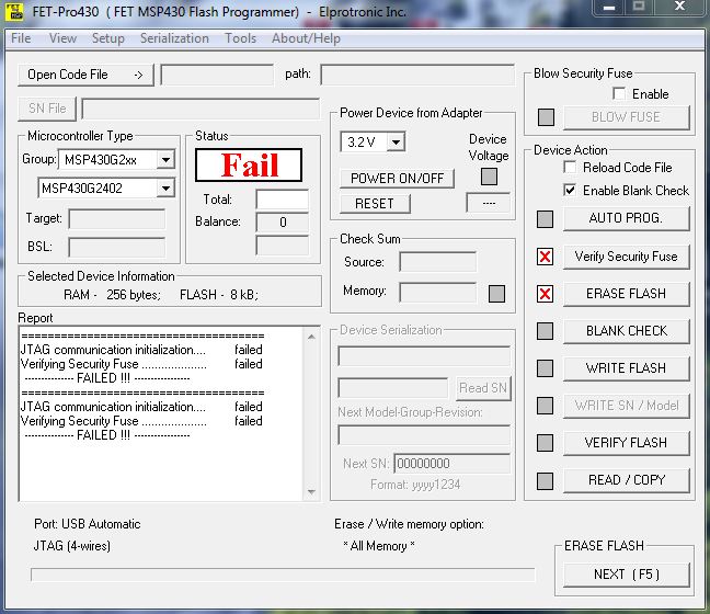

I downloaded the elprotronic software and tried using it - it fails too. See attached screenshot.
Did the two lines that disable the pull up resistors kill the G2402? I have looked at all the I/O lines on the schematics and none of them should damage the G2402 just because the pull ups get disabled on the chip. Can someone give me some ideas to try to see if I can recover these two boards without having to replace the G2402? Thanks in advance.
