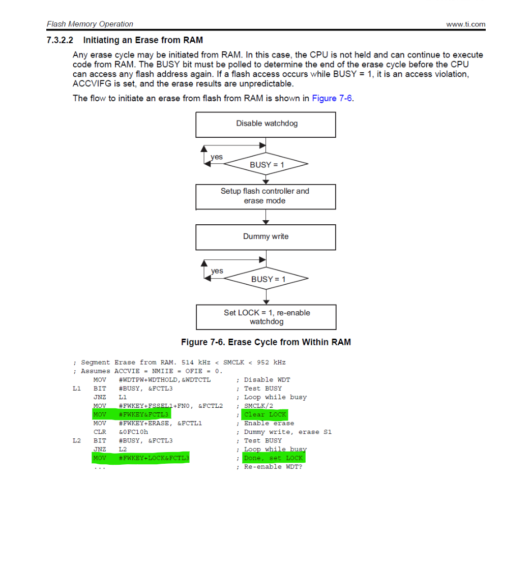

In order to be much specific: I use the SEGMENT D of the Info Memory as an EEPROM and, to do that, I set and clear the LOCK bit as it is described in TI MSP430x2xyz familly's datasheet (section 7 as Britta mentioned in her post).
After erasing D segment I write on it my data so that I can store them also when the machine is shut off. To do this I use the same procedure described in TI datasheet (chapter 7, paragraph 3)
I think this is the correct procedure to erase and write on my D segment, isn't it?
So, programming the FLASH in this way, is it possible that the Flash memory is no longer being lock?

as you said you are erasing and writing to Segment D according to the User's Guide it should be fine.
As said before, while you erase and write to Segment D the whole Flash is unlocked (except for Info Memory A) until your erase/write operation is done and you lock the Flash again.
