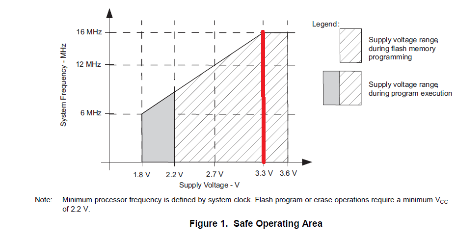

  • Hi Walther!
    thank you for your answer and your questions about the problem.
    1. The frequency is set at the maximum possible internal oscillator value: 16 Mhz, while the voltage is 3,3 V.
    2. I have a function in the code that reads and writes the info memory. Exept of this the FLASH memory is only read in some particular location in the code.
    3. Yes, only 7 devices on 50 shows this issue and, yes again, it is always the same: the RESET vector isn't located to its specific address.
    One important thing to highlight is that the processor has worked well for some months, then suddenly happens this strange fact.
    Thank you also for the link to the App Note.. I'll read it!
    Kind Regards,
    Luigi
  • Hi Luigi,
    thanks for answering the questions. You operate the device at 3.3V at 16 MHz right. This means you operate on the border of the specification as you can see below.
    On the top you also use flash programming which is causing high peak currents. Therefore I really have to ask:
    Are you sure that you will not violate the 3.3V spec with 16 MHz during whole operation (means temperature, all kind of code execution).
    Normally LDO does not react very quick on short spikes which might cause problems.
    So can you reproduce the behavior? If yes please increase DVCC or reduce frequency to see if it disappears.

  • Hi Luigi,
    I understand your concerns but again if you operate at 3.25V at 16 MHz you will violate the specification also keeping in mind the DCO drift over temperatuer.
    But to better understand what's going wrong:
    Are there any signficant differences to the applications your company produced before?
    Do peform DCO frequency switching in your application? If yes are all the existing ERRATAs considered?
