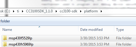

    The CC3100 SDK (1.1.0) contains 2 different msp430 platforms (fr5969 and f5529).
    Please compare the files in these folders, maybe you overlook something (a typo for example).

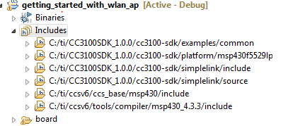

    I am trying to port given example code for MSP430F5529lp to MSP430F5510 by creating a new work space.
    I have included all relevant files into  the work space.  When I try to build it , I get error "cannot open source file simplelink.h".
    After comparing with example code workspace  I found , I am missing following.
    How to get these include ?
    Please help me.
    Vivek
