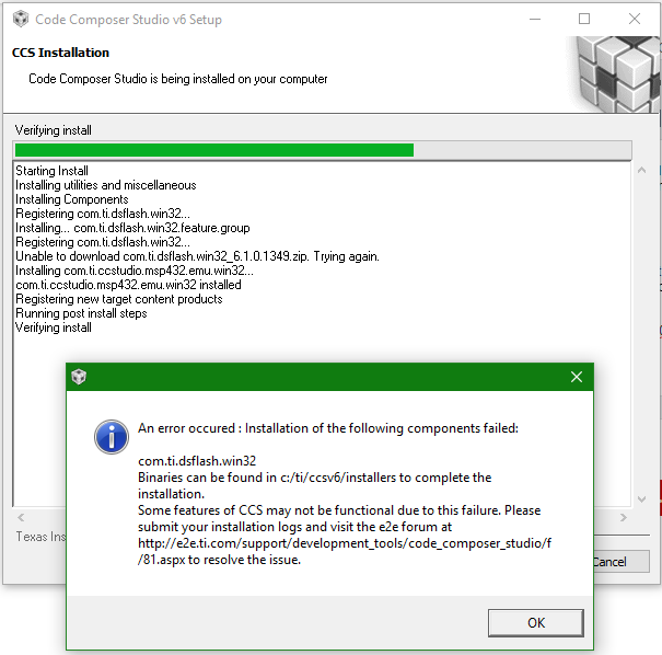

  • Hi there,
    Having an issue with this update. I downloaded and completed the CMSIS update program. However, starting CCS after this update leads to a lock-up while it is trying to update the CCS components related to this change. See attached picture. I'm running Windows 10.
    It submitted a bug report, I think the reference was #17387.
    Also, why does it install to /ti/msp by default? Previous versions of the mspware went into /ti/msp430. Doesn't having these conflicting versions co-exist cause some sort of problem?

  • Hi Alexander,
    thank you for reporting the issue to us! We are looking into the issue and will let you know once there is any update. We appreciate your patience with the delay due to the holiday season.
    ~Dung
    P.S.: regarding ti/msp, moving forward (starting with CCSv6.2 or later) all content for msp (msp430 & msp432) such as mspware will be installed to ti/msp. For the time being, some hooks are put in place to allow CCS to search for MSPWare content in both ti/msp & ti/msp430 folders.
