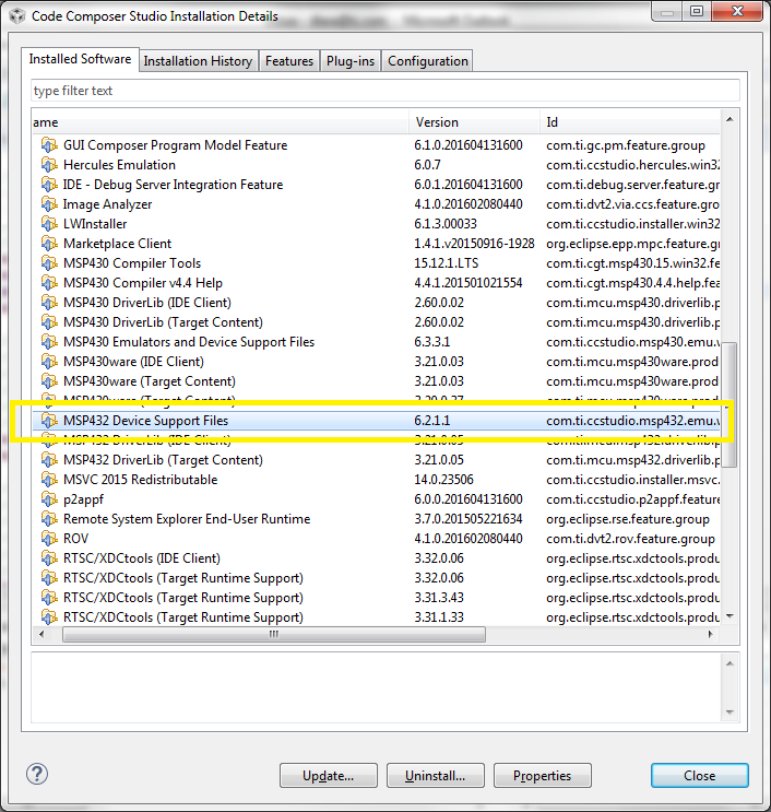

I have up-to-date CC Studio and up-to-date MSPWare and Driverlib. Today I tried to compile and PWM example and still I am getting following error. I re installed CCS and mspware still I am getting following error. I also tried code converter tool but with converted files also I am getting same error. Kindly advise me what to do?
"C:\ti\ccsv6\ccsv6\ccs_base\arm\include\msp432p401r.h", line 69: warning #1181-D: #warning directive: "MSP432 software will be updated to use CMSIS-Core in March 2016. This update will allow your MSP432 software to be CMSIS compliant, but require modification to your existing MSP432 code. A beta release is available if you want to start converting your code today. Refer to http://www.ti.com/MSP432CMSIS for detailed changes, conversion guide and background information."
"../timer_a_pwm_mode.c", line 71: error #20: identifier "TIMER_A_CTL_SSEL__SMCLK" is undefined
"../timer_a_pwm_mode.c", line 75: error #20: identifier "TIMER_A_CCTLN_OUTMOD_7" is undefined
"../timer_a_pwm_mode.c", line 87: error #20: identifier "CS_CLKEN_MCLK_EN" is undefined
"../timer_a_pwm_mode.c", line 87: error #20: identifier "CS_CTL1_SELM_2" is undefined
"../timer_a_pwm_mode.c", line 87: error #20: identifier "CS_CTL1_DIVS_0" is undefined
"../timer_a_pwm_mode.c", line 88: error #20: identifier "CS_CLKEN_SMCLK_EN" is undefined
"../timer_a_pwm_mode.c", line 88: error #20: identifier "CS_CTL1_DIVS_1" is undefined
