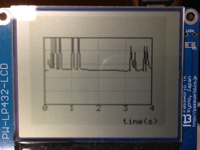

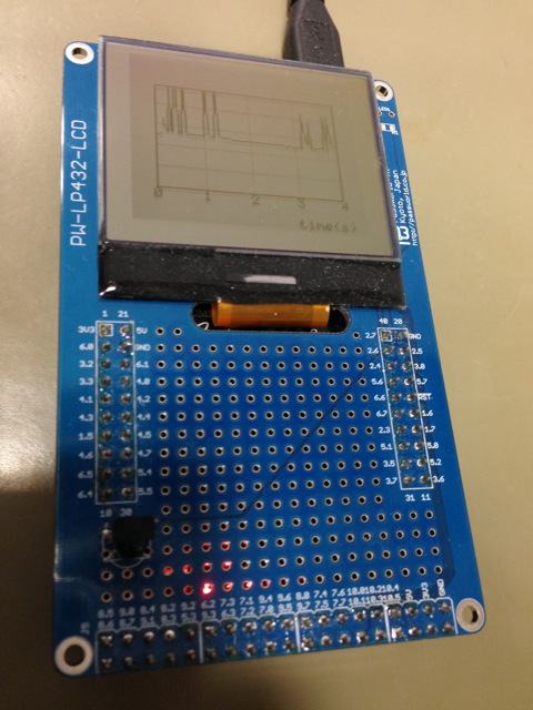

    I have made this boosterpack (1 LCD, 1 microSD card, i IR receiver). The LCD is
    an extremely low consumption device (without backlight), and 16 gray levels.
    You can notice the gridlines, written in gray, that look thinner than the border.
    The curve is just the ADC input with nothing plugged, therefore this erratic
    behaviour (I was just touching the input pin to check if it works).
