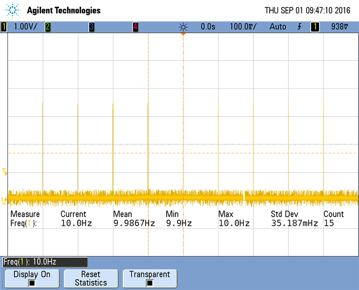

  • Hi Jinkwon,
    only for completness I tried on my bench if low duty cycle on the 10 Hz PWM using the TimerB will be a problem and I can confirm it is not!
    I tried on F169 Rev E using following code:
    void main(void)
      WDTCTL = WDTPW + WDTHOLD;                 // Stop watchdog timer
      TBCCR0 = 3277;
      TBCCR1 =  3275;
      P4SEL |= 0x02; //P4.1 ??. TB1? ?? ?? ?.
      P4DIR = 0x02; //TB1 ?? ???
      TBCCTL1 =  OUTMOD_2;
      TBCTL =  TBSSEL_1 + MC_1;
      while(1);
    }//end of main
    As shown in the scope shot below the 10 Hz PWM works find with very low duty cycle:
