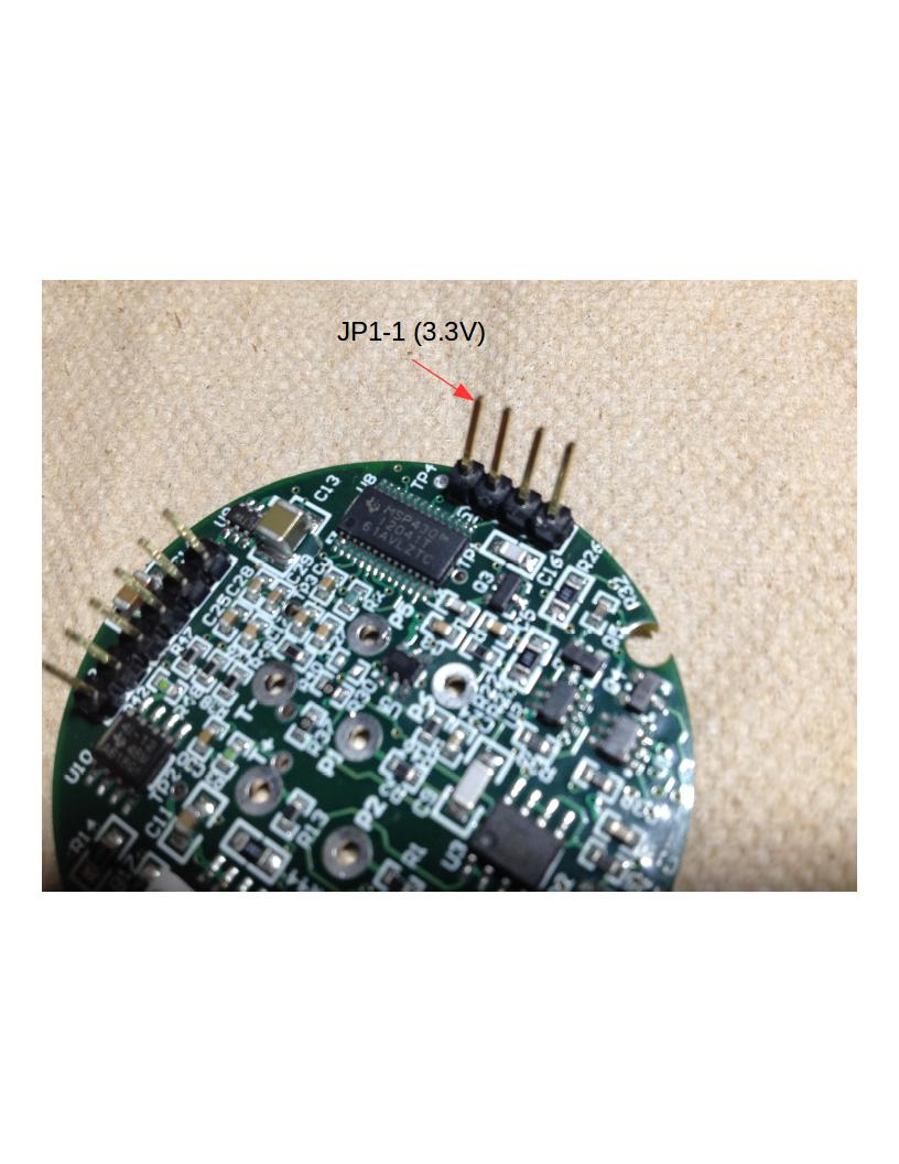

  • Cameron,
    I am trying to contact the Hardware Engineer or the layout consultant
    In the mean time, I am sending you a photo of the board, JP1 is the SBW connector, which is very close to micro pins 15 and 16.

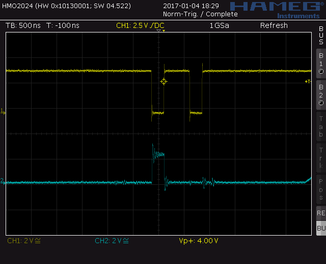

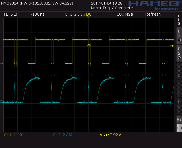

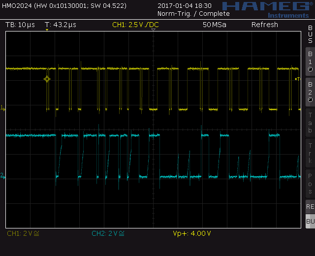

  • 1) I used Elprotronic FET-Pro430 Lite software and TI MSP-FET emulator both the old, UIF as well as the new (the black one), being able to program if internal supply and 2.0V. I think people in production used the Elprotronic SW and HW same results, 2V only (I will confirm tomorrow morning)
    2)  My CCS 6.1.3 is up to date and even tried CCS 7.0.0 in another computer. No positive results
    3) These are some waveform I took for the 6 layers, on Jan/4 during the flashing session. Seems it runs some handshake but  I did some random capture, CH1 (Top) is CLK and CH2 is TDIO
    Marco
    FIG 1 ) Trigger is at TDIO which seems at HALF the voltage
    FIG 2 ) Zoom out view of FIG 1) Trigger is at TDIO which seems at HALF the voltage
    FIG 3 ) Just SBW activity
