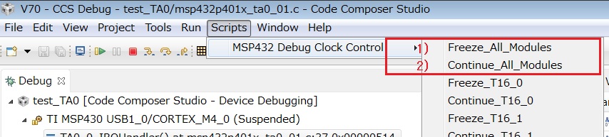

The easiest way to make it work, is to use the built-in functionality in CCS. While you are in the debug session perform the following steps:
Which TimerA module you need to select, depends on your target code. For example "Freeze_T16_0" halts the TimerA0 module.

I found how to stop interrupt briefly at step debugging with MSP-FET and CCSv7_1.
As bellow, Clock control Script can Freeze (disable interrupt) and Continue (enable) all modules well.
I’ve confirmed these behaviors with example msp432p401r_ta0_01.c.
If this can resolve your issue, please click Verify Answer.
