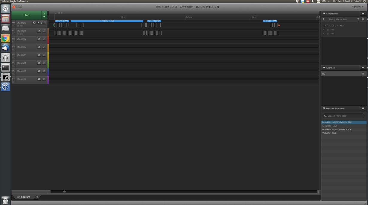

    Thanks for the clarification. Have you been using a logic analyzer to observe the I2C bus? Can you provide screenshots of what you're seeing? I'll take a deeper look into your code and make sure you're meeting all the requirements necessary to interface with the bq27441-G1.
    Caleb Overbay
  • Hello Caleb,
    Please find attached screenshots from my logic analyzer. I have two battery booster packs and two screenshot shows output received by running code on each of those. To add to my confusion, the output received is different. I think the one which sends back ACK on address 0xAA at least shows some progress whereas other one doesn't acknowledge the address sent. See if you can get anything from these about what's going wrong.
  • Hi Anand,
    Thank you for providing the screenshots. The write with a NAK in response is peculiar to me. Have you ensured you're using the 10K pull-up resistors recommended in the BQ274411-G1 datasheet?
    After looking at your code, I see a few things wrong with it. To execute the intended command you can send 0x0C OR 0x0D and you need to follow the following format specified in the BQ274411-G1 datasheet:

  • Hello Caleb,
    I have incorporated the code sample that you have sent to me. And these are the results I am getting which still dont make sense. (Code is command I sent to booster pack, and result is what I get back).
    Code: 0x00, Result: 3072 (CONTROL_STATUS)
