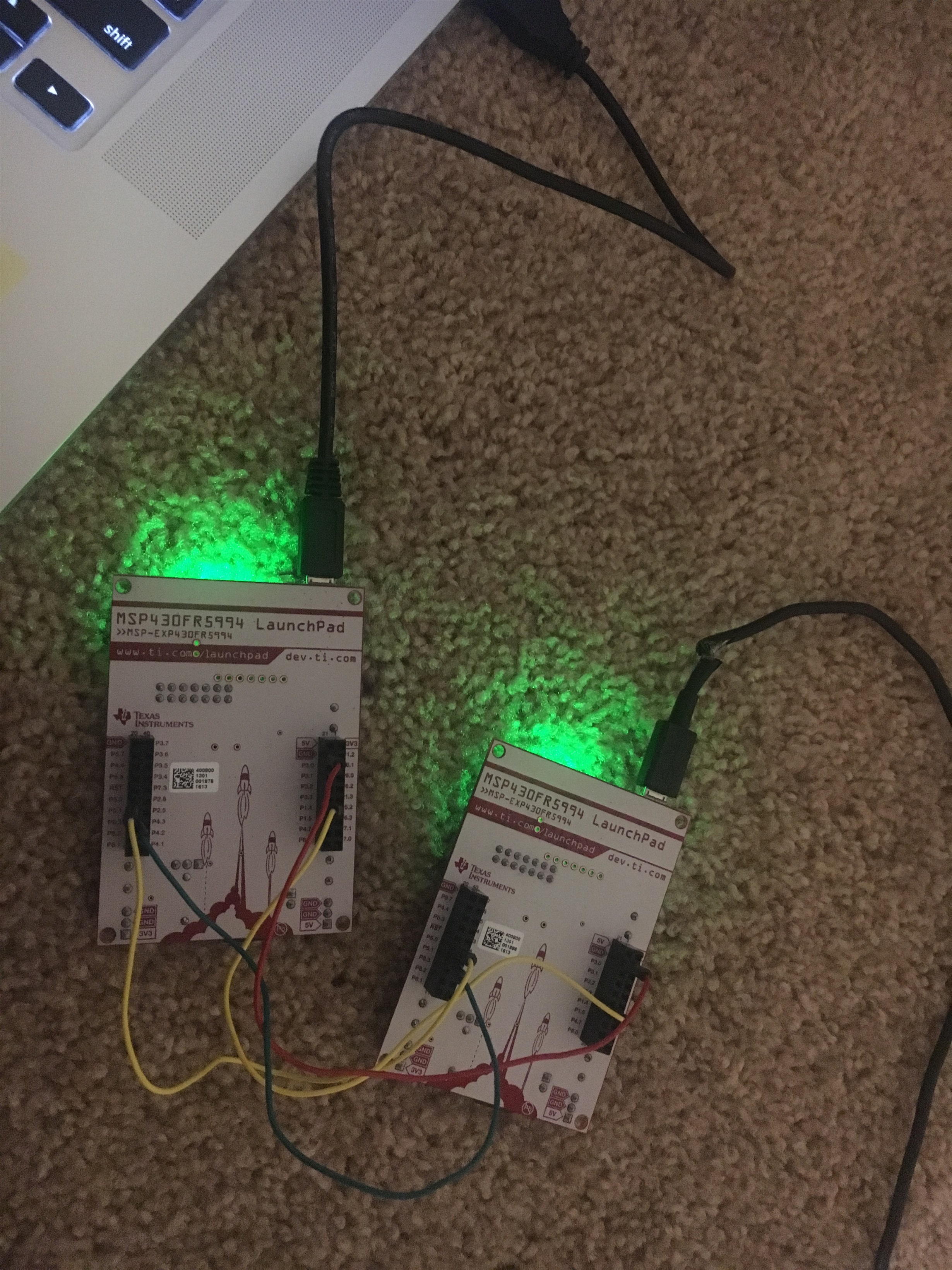

CCS/MSP430FR5994: Slave code does not enter the interrupt vector
Part Number: MSP430FR5994
Other Parts Discussed in Thread: MSP430FR5969, , MSP430WARE
THIS IS MY MASTER CODE

THIS IS MY SLAVE CODE:

I have two MSP430FR5994 boards and I want to use SPI communication to make both boards transmit to and receive from one another. I am working with the example code provided by TI and have changed port and pin numbers in the code depending on my board.
When I run my master code on one board, the toggling of the LED happens as I increment my TXData without any connection to the slave. When I debug the slave code on the slave while it is connected to the master on which the master code is running, the slave code never enters the interrupt vector to receive the data sent by the master.
I want to use eUSCI_B1 ports for SPI so I have connected the following pins between both boards:
5V to 5V
GND to GND
P5.2 to P5.2 for UCB1CLK
P5.0 to P5.0 for UCB1SIMO
P5.1 to P5.1 for UCB1SOMI
P5.3 to P5.3 for UCB1STE
Where am I going wrong?

  • Start with just the eusci_b_spi_ex1_master and eusci_b_spi_ex1_slave code, port to the FR5994, and get the simple example working before adding 4-wire mode and changing eUSCI_B peripherals. You do not need to connect the 5 V rails as they are not used (MSP operates on 3.3 V). Oscilloscope or logic analyzer screenshots would also be quite helpful. www.ti.com/.../slaa734.pdf
    Ryan

  • Your SPI connections are correct and you mentioned that the GND lines are connected but how is each LauchPad powered? The slave is most likely connected to your PC through the eZ-FET so that you can use the CCS debugger, is the master powered through its eZ-FET as well or from the slave Vcc/external power supply? If either of the latter then make sure to disconnect the eZ-FET headers, and keep in mind that 5 V is not required for this example. You can also try the FR5994 C code examples to see if these offer any different results.
    Ryan
  • I read somewhere that pin 5.0 of the master needs to be connected to pin 5.1 of the slave and pin 5.1 on the master needs to be connected to pin 5.0 on the slave. Is that true?
    So should I remove the connection between the 5V ports of the two boards? Should I connect the 3V ports of the two boards with a cable instead?
    So the slave is connected to my PC via a USB cable (what is an eZ-FET?) and the master is powered through an external power supply. Where are eZ-FET headers....are they in the code?
    I wasnt able to find FR5994 C code examples. Searched in a lot of places. The closest I got FR5969.
  • So now currently the ports that are connected are:
    GND to GND
    I removed the Slave Select as I am trying the 3 pin code again
    Thank you so much for all your help! I really appreciate it!
  • The issue at hand is your PxSEL bits for P5.0 to P5.2. You are still using the GPIO_SECONDARY_MODULE_FUNCTION on the eUSCI SPI pins from when this example utilized UCB0, changing them to GPIO_PRIMARY_MODULE_FUNCTION will fix the issue. Keep the connections as shown in the images. SPI C examples (native UCB1) can be downloaded from the product's tools & software page: www.ti.com/.../slac710
    Ryan

    So when I debug the master code without the slave attached, I am able to send TXData=1 twice but not more than that as it gets stuck at __bis_SR_register(LPM0_bits | GIE); instruction (hence the LED toggles to HIGH once and then back to LOW and then nothing happens). As usual, the slave code doesnt enter the interrupt vector when master is connected and running from external power source.
    So the goal of my program is to send a 1 from the master and get it received on the slave side. If I can get this simple example to work, from there I can build something more. To achieve this, I am trying to send TXData=1 repeatedly from master side and want to receive it on the slave side so I have an if statement that if (rX==1) toggle lights.
    I believe what is happening is the send and receive are happening on the master side itself. We enter case USCI_SPI_UCTXIFG: when data is ready to transmit and then enter case USCI_SPI_UCRXIFG: to save data received into RXData and reset the interrupt flags. How can I do this receive on the slave side instead of the master side?
    Thank you,
    Madhu
  • Your project has changed from Driverlib to C code format. Since you are sampling from the echo code the master is expecting to receive an acknowledgment byte from the slave (the same value just sent) before continuing communication. Therefore the ISR on the slave side should include the following line after storing the UCB1RXBUF to rX: UCB1TXBUF = rX;
    Ryan
