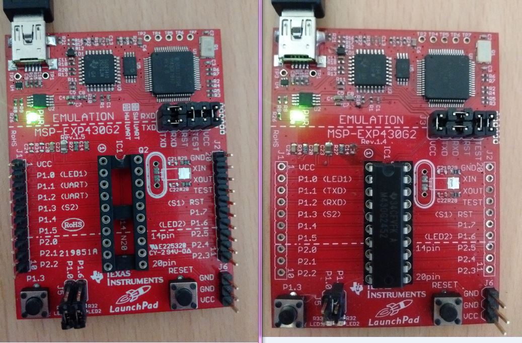

  • G'day Caleb,
    To minimise the things that could be causing it, I've simply bridged the connection (between the TXD & RXD pins) back to itself creating a loop-back circuit (if that's the correct name for it?). Essentially no signal ever makes it over the "Emulation/MSP-EXP430G2" line.
    The hub is being powered by one of my high power USB 2.0 outputs from my motherboard, but additionally the hub has an external power supply which is 2A.
    I have probed the TXD pin on the MSP-EXP430G2 both with and without the USB hub, both times it correctly pulls the pin high. Only difference is when I send data through a terminal I can see it transmitted without the hub. When I try transmit data when connected to the hub nothing happens, the pin stays high.
    EDIT: I also just tried another random USB hub from the shops, same result. Both identify as "Generic USB hub" in device manager. The operating system is Win7 x64

  • Hi Andrew,
    I apologize for the delay. We're trying to get our hands on a rev 1.4 G2 Launchpad to test this. So far we've been using rev 1.5. However, it looks like you have your jumpers connected incorrectly on the rev 1.5 board for a loopback test. The TX and RX pins of the debugger and target side are mixed. This means that the pins above the dashed line on the board to not exclusively belong to the debugger. One of the pins be longs to the target side. The pins should be connected as seen below to perform a loopback test:
    Can you try this out and let me know the results?
    Caleb Overbay
  • Ah, thanks for pointing that out. Unfortunately I'm away for the next week, but I'll try it as soon as I get home. Maybe the v1.5 was working the whole time, through the hub or not. We'll see!
    Andrew
  • G'day Caleb,
    I tried out the v1.5 with the correct (doh!) loopback wiring. It worked connected directly, but again, no joy when through the USB hub.
