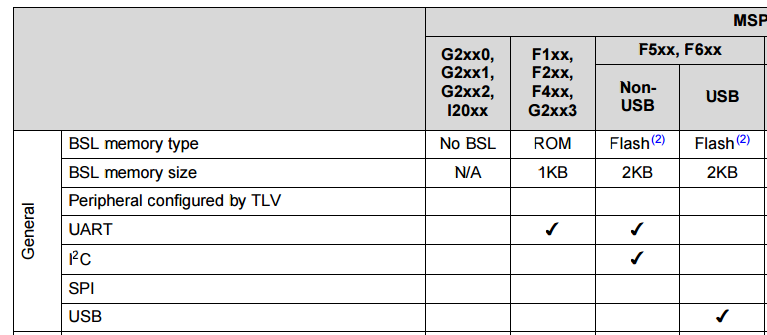

I'm using msp430f5659 mcu.
And, I want  to update firmware by another mcu(nordic nRF52832).
Msp430f5659 is connected by spi with nRF52832 in my schematic.
I planned over-the-air programming for msp430f5659 through nRF52832.
I know msp430f5xx series support UART, I2C and USB BSL.
But, when i read this wiki, it is possible to use SPI instead of I2C or UART.
I read msp430 can access bsl by ((void (*)())0x1000)() without reset.
Then, Where do i save binary code download by spi?
And, How to call binary code when calling ((void (*)())0x1000)()?
I don't know how to write binary code to main memory after called ((void (*)())0x1000)().
Thank you.

    If you want to use SPI for firmware update on MSP430F5659, the BSL on 0x1000 will not work for this. So you need to write your own BSL code.
    There are two documents and example code for your reference.
    1. MSP430FRBoot – Main Memory Bootloader and Over-the Air Updates for MSP430™ FRAM Large Memory Model Devices
    www.ti.com/.../slaa721a.pdf
    2. MSPBoot – Main Memory Bootloader for MSP430™ Microcontrollers
    www.ti.com/.../slaa600b.pdf

    There is no example code for msp430f5659 in MSPBoot but you can refer to G2553_SPI which is flash base and SPI communication, similar to what you want.
    The UG slaa600a.pdf has detail description about the software package.
    Target: G2553_SPI ,
    Host: MSP-EXP430F538
    With BSL in 0x1000 it only support USB/UART, not SPI...
