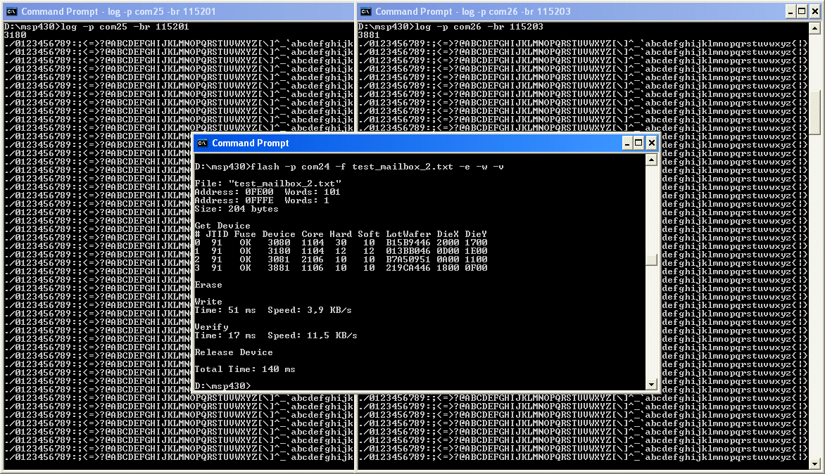

  • BTW, for logging can be used also mailbox system,  that can transfer double word at once (not byte by byte as UART), using only SBW connection, leaving all device peripheral / pins free. Unfortunately, it is not supported by TI FET's.
  • Wow Zrno, that looks pretty awesome. Do you have any tips on how to set that up?
    thanks,
    -Skot
