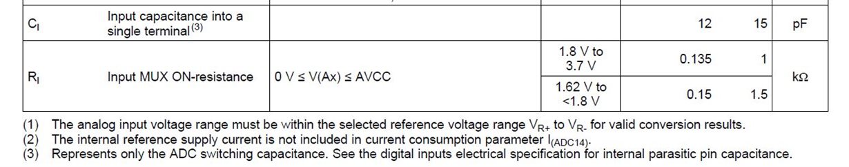

  • Scott,
    The current consumed by the ADC input is that required to charge the sample-and-hold capacitor in the ADC. This is typically 12pF (Table 5-26 in the datasheet). If the battery is 3V and the sample capacitor is 12pF then you would consume about 36pC (not considering other parasitics). You will find that charge is not thrown away and that subsequent measurements of the same channel do not ‘consume’ as much current – but you still need to make sure that the sample-hold time is sufficient to get to the present voltage and not some intermediate voltage (based upon RC) between the present and previous voltages.
    To your point, I cannot find any information about the ADC impedance/leakage when the IO is not being sampled. The digital IO specification for leakage is 20nA (max) and the Roff impedance of the comparator (analog input) is on the order of 50Mohms typical (comparator, table 5-34). I will ask for clarification, but I would not expect the value to be very different from the comparator. I will ask that this be updated in the datasheet.

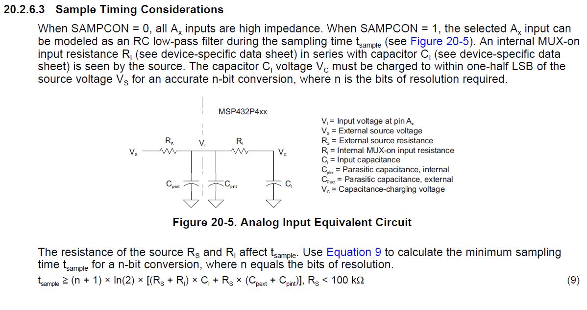

  • Thank you, Chris,
    I understand how you arrived at 36pC, assuming the sample capacitor is charged up to steady state, since Q = V * C.  However, that doesn't quite tell me what the current is, since it will be dependent on the input impedance (or resistance) of the ADC input before the capacitor.
    Also, the same capacitor is used to hold the voltage for each channel that is in use, so if we are swapping between multiple ADC14 channels, it's a bit hard to predict how much charge would already be on the preceding channel.
    If you can find any more info about the input current or input impedance for the ADC14, I'd appreciate it.  I guess the key for my EE counterpart would be the input impedance and maybe the equivalent circuit, from which we could calculate the input current.

  • Scott,
    The impedance and equivalent circuit can be found in the datasheet and the TRM, respectively.  In the datasheet you can also find in the notes an example where the sample hold time is calculated based upon example values for Cpext and Cpint.  I will continue to work to get you more information about the off state.  Additionally, you always have the option of turning the Analog input back into a high-impedance digital input to ensure that you get the leakage provided in the datasheet.
    http://www.ti.com/lit/ds/symlink/msp432p401r.pdf#page=64
    http://www.ti.com/lit/ug/slau356f/slau356f.pdf#page=670
    Chris
