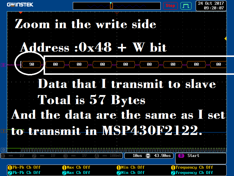

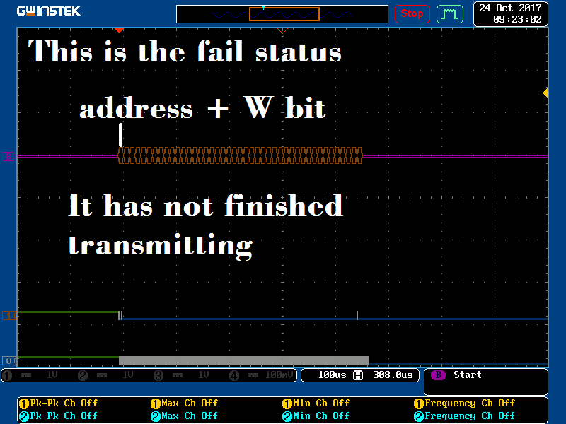

  • Hi Ryan and Caleb,
    With the advice from Ryan, I changed  some part of my I2C communication code.
    But if I do not check whether the buffer of TXD is empty or not, the data to transmit will not successful.
    Now, I cancel the reset part of the I2C communication.
    I will paste the code below, void I2C_Multiple_Read_Write(unsigned char Length,unsigned short number_of_read)
    As the following figures, they are the screenshot from Oscilloscope.
    And I have write the meanings on the figures.
    Each time the fail operation occurs, it happens in the part of transmitting.
    I have not finished transmitted the data and it stuck, so I think the error is in the chip MSP430F5632 which my slave device of I2C right?

  • Hello Norton,
    The "unknown signal" at the end of the receive is because you are sending the stop command too late, as I mentioned previously. Does your MSP430F5632 not acknowledge the last byte which resulting in communication failure, and is it always the same byte of 57 in the same sequence count? This could be a logic issue and you should debug your slave device at this point. Adding NACK handling to your master code could also help escape a locked state.
