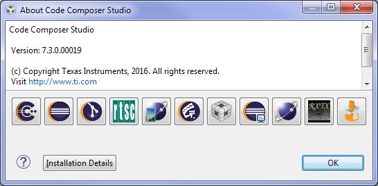

I have installed Code Composer 7:

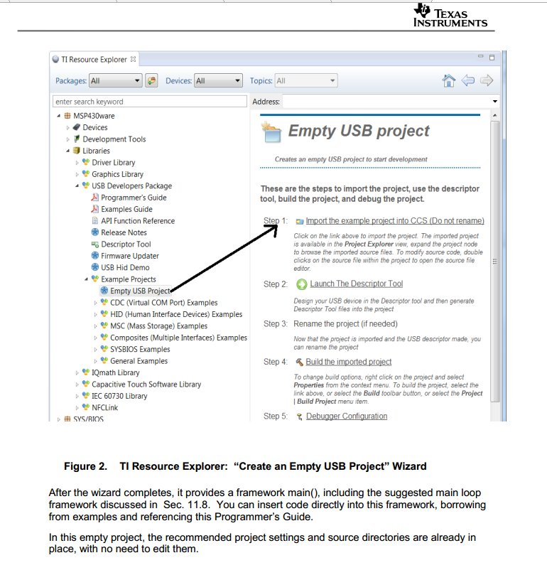

I am referring to the MSP430 USB Programmer's Guide:
on page 24, installing Empty USB project:

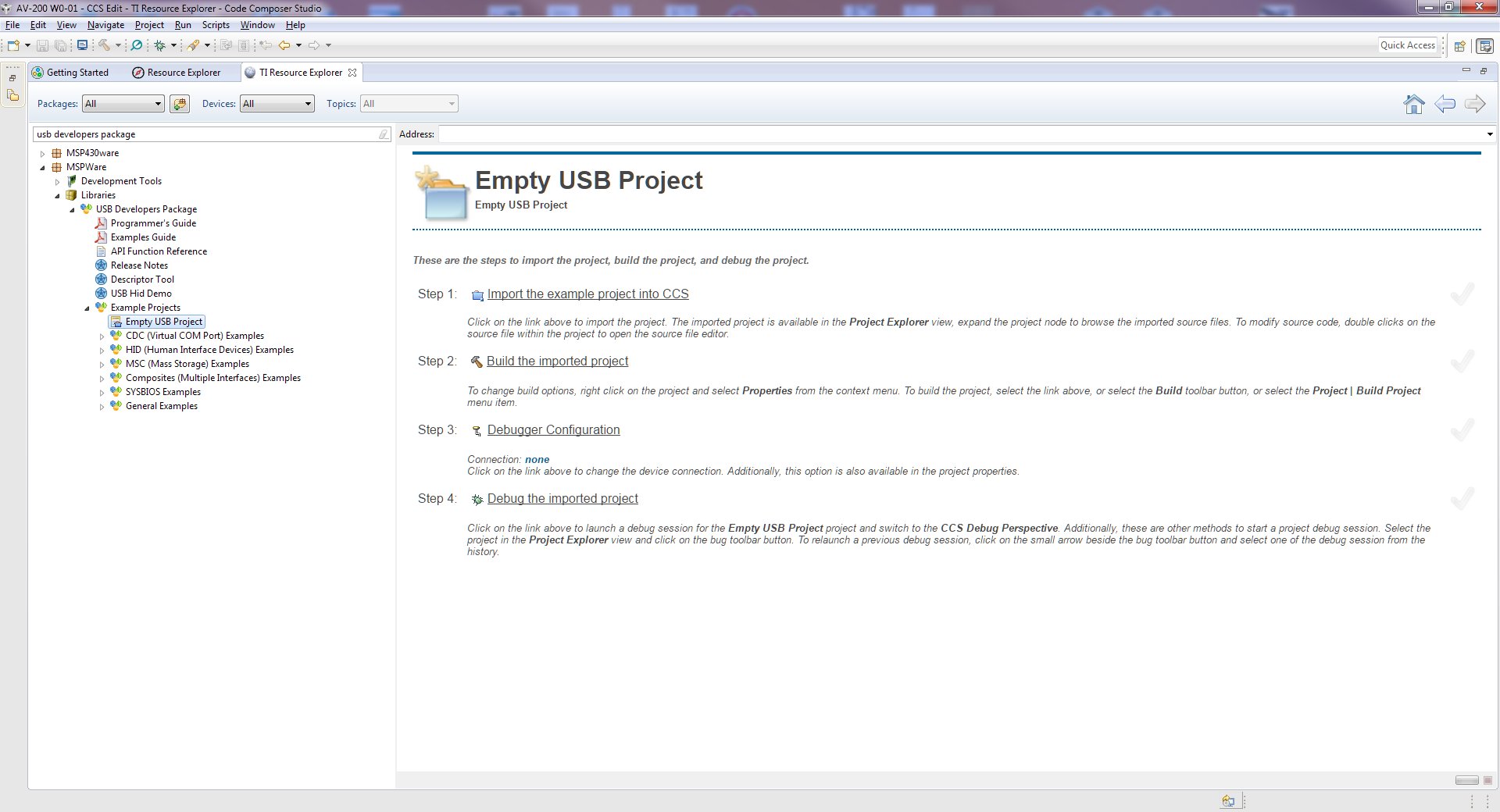

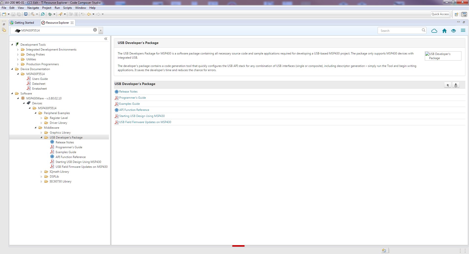

In code composer resource explorer, there are no example projects:
In Resource Explorer Classic, there are two options, MSP430ware and MSPware. Neither match the Programmers Guide:
How do I get an Empty USB project as per the USB programmers guide?

    Use Resource Explorer Classic if you would like resources which follow the USB Programmer's Guide, but you need to have MSP430Ware v3.8 installed instead of v1.4. You could also import a simple example from the non-classic version and remove the parts you do not require.

    However, neither version of the resource explorer shows the complete package especially the non-classic version which only shows the documentation.
    There are some issues with how this works with CCS7.
  • Is there a bug reporting process for CCS7?
  • Classic is only going to work with v3.7 or earlier. I'm not sure what the non-classic version chooses to show or not. If you would like to move forward with development then you could simply import projects from MSPWARE or MSP430USBDEVPACK without the assistance of the Resource Explorer.

    Part of the issue seems to be not installing CCS7 in the default location. I was doing this as my WIndows 7 partition was getting too full, so over the weekend I decided to deal with that. It was another exercise in frustrating and time consuming issues with cloning my Win7 partition to a new SSD however late Sunday I managed to get it done.
    So I reinstalled CCS7 in the default location and manually installed MSPWare in it's default location and now Resource Explorer can find most of MSPWare (still can't  find the Empty USB project though). I have imported the LED ON/OFF example project with Resource Explorer and this will get me going now.
