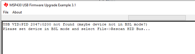

Does use the host software in the "MSP430USBDevelopersPackage_5_20_06_02" like "Python_Firmware_UpgraderGUI.exe"?
The GUI is like this
For the USB develop package is download here http://www.ti.com/tool/MSP430USBDEVPACK
Best regards
Gary
Hi Tao
I have try it on my side with this software and the LED blink demo with no problem.(I use the msp430f5514 with the MSP-TS430RGC64USB target board)
Here I have two suggests:
1. make sure the customer make right operation to invoke the BSL: Pull up the PUR to VBUS when power on the device.
2. measure the high speed crystal works well (If they can give the wave capture is better)
