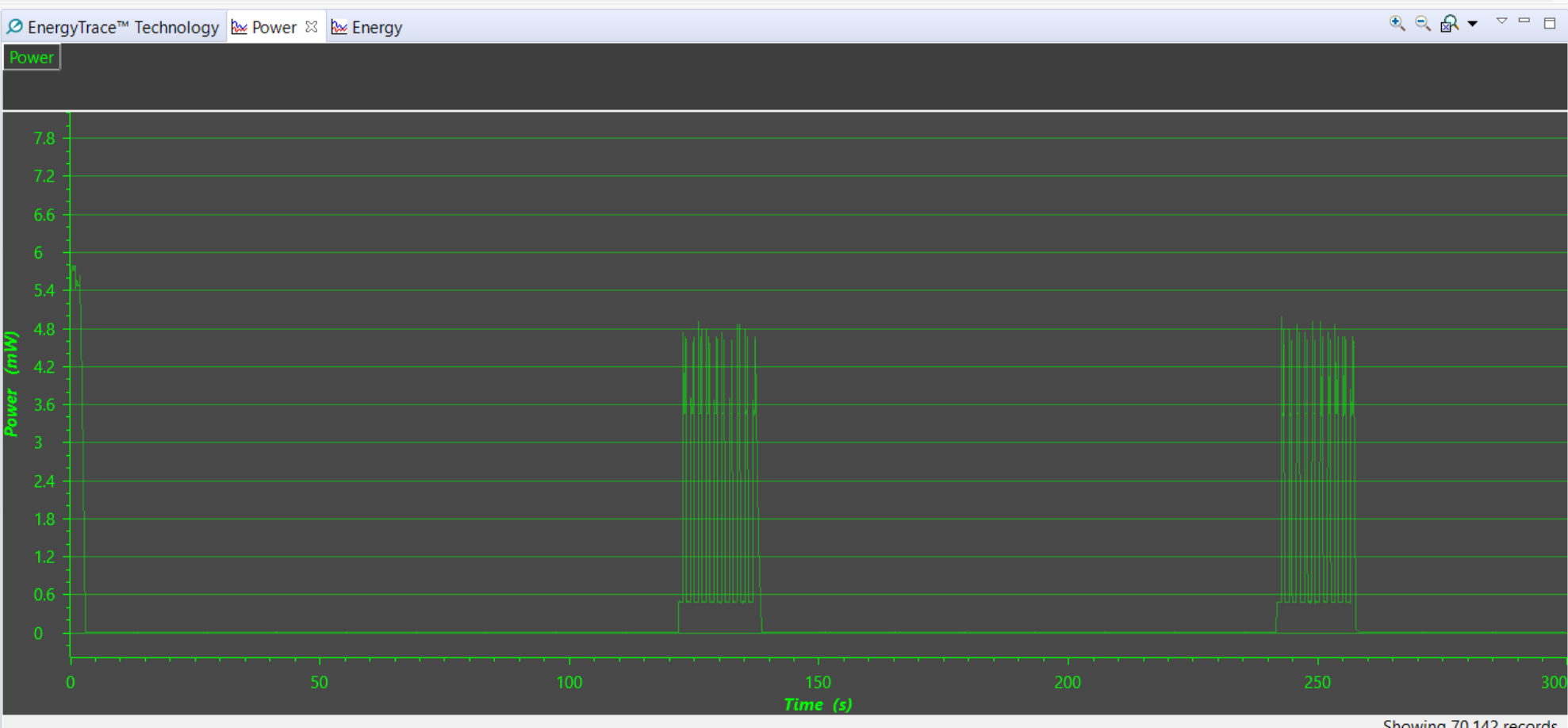

  • Thank you for your reply,I changed to another circuit board for testing. Without gotoLPM3, the current is 7mA larger than that in gotoLPM3.
    So I think the msp432 in a state of sleep.But the circuit can also test the current of 4 mA. I think maybe there are other electronic components on my circuit board, which are consuming electricity.I'm still looking for ways to reduce MSP432 power consumption.
  • Thank you for your reply . I changed to another circuit board for testing. Without gotoLPM3, the current is 7mA larger than that in gotoLPM3.
    So I think the msp432 in a state of sleep. But I still have a question?In the pcm_go_to_lpm3 example in the SDK,low MCLK is used. And no other peripherals are used. But in my project,I use the highest MCLK frequency of 48MHz, and I still use many peripherals, such as DMA, UART, SPI.In such a case, after calling the gotoLPM3 function, do these peripherals automatically shut down to reduce power consumption? If the peripheral does not shut down automatically during sleep, does it need to be closed manually before entering sleep?
  • Hello Alex
    When using the Rude mode, it will shut down the clocks to the peripherals. However that is not recommended if your application controls the peripherals. There must always be graceful shutdown. Now if it is possible to separate the supply for the MSP432P401R from rest of the circuit then I would advise measuring the currents separately.
    I have an example in the SDK
    C:\ti\simplelink_msp432p4_sdk_2_10_00_14\examples\nortos\MSP_EXP432P401R\demos\cmsis_dsplib_vibration_msp432p401r
    which does the same thing, i.e. put the device in LPM3 state from Active state with 49MHz (ignore the comment that it is LPM3.5). I ran the code and checked with CCS Energy Trace and the current does drop down to uA level. Attached is a snapshot for the Energy Trace.
