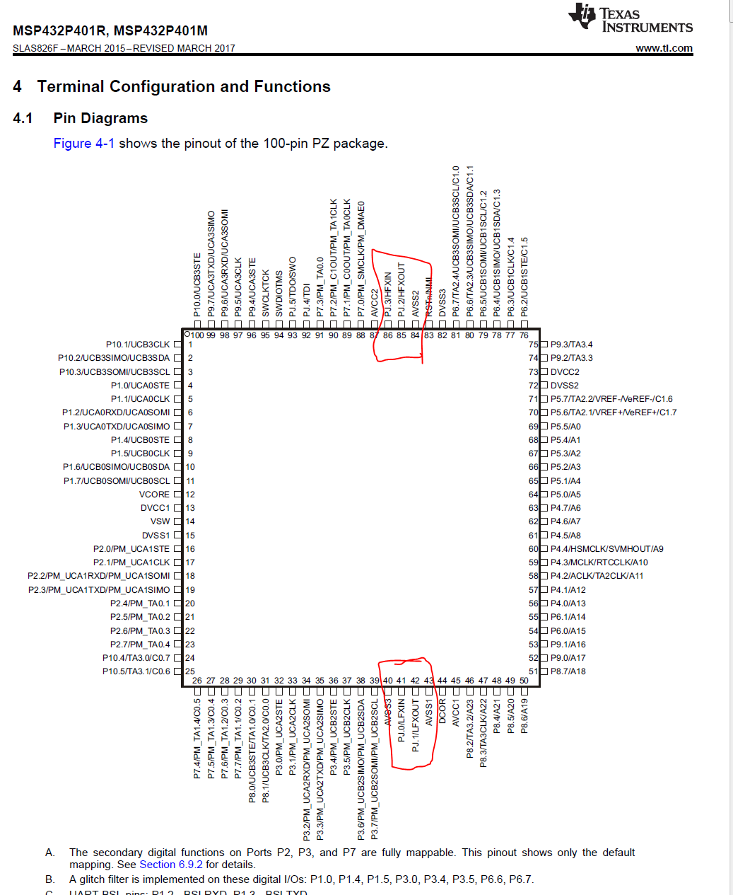

Compiler/MSP432P401R: Cannot set MCLK to 48MHz
Part Number: MSP432P401R
I am trying to set MCLK to 48MHz by using MAP_CS_initClockSignal(CS_MCLK, CS_HFXTCLK_SELECT,CS_CLOCK_DIVIDER_1);
but MCLk just stays at 32768Hz. Here is my code:

    CS_setExternalClockSourceFrequency(32000, 48000000); //set LFXTCLK to 32KHz and set HFXTCLK to 48MHz
    /* we have to change VCORE to 1 to support the 48MHz frequency */
    MAP_PCM_setPowerState(PCM_AM_LDO_VCORE1); // Active Mode, Low Drop Out, VCORE0; see datasheet pg. 353 Table 7-1
    MAP_CS_initClockSignal(CS_MCLK, CS_HFXTCLK_SELECT,CS_CLOCK_DIVIDER_1); //set MCLK to 48MHz

I also tried to call MAP_PCM_setPowerState(PCM_AM_LDO_VCORE1) before I called CS_setExternalClockSourceFrequency(32000, 48000000), but still failed (still getting 32768).
I verified that MAP_CS_initClockSignal function is working because if I change CS_HFXTCLK_SELECT to sth else, I can get the correct value.
