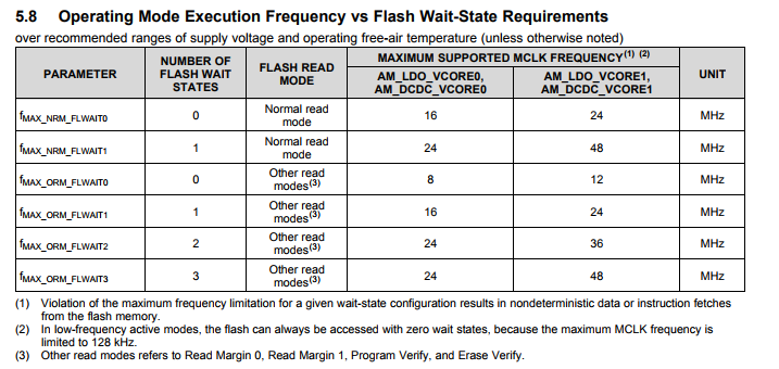

dear all,
i set the clock as 48MHz with below code:
 CS_setDCOCenteredFrequency(CS_DCO_FREQUENCY_48);
if i use RevB device, it will no problem. but when i use RevC or RevD, the code will stop at this function.
when i add two codes as before CS_setDCOCenteredFrequency like below:
    FlashCtl_setWaitState(FLASH_BANK0, 2);
    FlashCtl_setWaitState(FLASH_BANK1, 2);
the bug will be debugged. so why RevC or RevD need to add these code and is this way is right?
could you please share some standard example code about setting clock?
thanks a lot.
  • amien,
    I won't speak to Rev B, but Flash Wait-State are necessary as the flash cannot be written to at 48MHz. Please do not use Rev B as that is experimental silicon that is not RTM material.
    From the datasheet:
    On Rev C/D we improved Flash Wait-States to only need 1 wait state when writing to flash at 48MHz for NRM.
    Here is a tested example that achieves what you are looking for.
