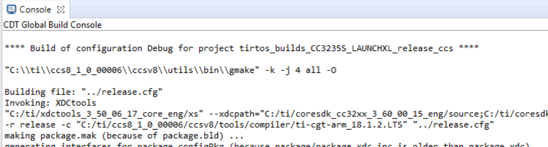

I am currently trying to run TI-RTOS example projects on an MSP430FR5994 Launchpad. I am using CCSv8 to import TI-RTOS example projects from Resource Explorer. I can import and build the projects just fine without any issues, but none of them seem to run after loading. All of them report 'MSP430: AutoRun: Target not run as the symbol "main" is not defined' to the console, even though each of the projects contains a main function. Additionally, none of the messages from the projects were printed to the console. I also tried creating a new project using a TI-RTOS Empty Project template for the launchpad - which comes with code to toggle one of the on board LEDs. The idea being that if it was just the debug interface that was affected, I should still see the LED toggle. When running this project I get the same message about main not being defined and the LED on the board did not light up. Later, I loaded a non TI-RTOS example project that lit the LEDs to verify that there weren't any issues with the Launchpad hardware. After searching on this forum I haven't been able to identify any solutions. Any help would be appreciated.

  • Benjamin,
    Can you import the UART Echo example, build it (unmodified) and then copy/paste the build output into a file and attach it? Please don't copy/paste into a reply; attach the file instead to prevent the thread from getting too long.
    Todd
  • I just ended up changing the .out extension to .txt. Copy and pasting it as text just pastes **ELF** without getting all of the random characters.
    uartecho_MSP_EXP430FR5994_TI.txt
  • HI Benjamin,
    Sorry, this fell through the cracks. I don't mean the .out file. I mean the build log output.  It will look something like this.
    Again, please copy/paste into a .txt file and attach.
    Todd

    **** Build of configuration Debug for project uartecho_MSP_EXP430FR5994_TI ****
    "C:\\ti\\ccsv8\\utils\\bin\\gmake" -k -j 4 all -O
    Building file: "../uartecho.cfg"
    Invoking: XDCtools
    "C:/ti/xdctools_3_32_00_06_core/xs" --xdcpath="C:/ti/tirtos_msp43x_2_20_00_06/packages;C:/ti/tirtos_msp43x_2_20_00_06/products/bios_6_46_00_23/packages;C:/ti/tirtos_msp43x_2_20_00_06/products/tidrivers_msp43x_2_20_00_08/packages;C:/ti/tirtos_msp43x_2_20_00_06/products/uia_2_00_06_52/packages;" xdc.tools.configuro -o configPkg -t ti.targets.msp430.elf.MSP430X -p ti.platforms.msp430:MSP430FR5994 -r release -c "C:/ti/ccsv8/tools/compiler/ti-cgt-msp430_18.1.1.LTS" --compileOptions "-vmspx --data_model=restricted --use_hw_mpy=F5 --include_path=\"C:/ti/ccsv8/ccs_base/msp430/include\" --include_path=\"C:/Users/benja_000/workspace_v8/uartecho_MSP_EXP430FR5994_TI\" --include_path=\"C:/Users/benja_000/workspace_v8/uartecho_MSP_EXP430FR5994_TI\" --include_path=\"C:/ti/tirtos_msp43x_2_20_00_06/products/msp430_driverlib_2_70_01_01a/driverlib/MSP430FR5xx_6xx\" --include_path=\"C:/ti/ccsv8/tools/compiler/ti-cgt-msp430_18.1.1.LTS/include\" --advice:power=all --advice:power_severity=suppress --advice:hw_config=all --define=__MSP430FR5994__ --define=_MPU_ENABLE --define=ccs --define=MSP430WARE -g --printf_support=minimal --diag_warning=225 --diag_warning=255 --diag_wrap=off --display_error_number --abi=eabi --silicon_errata=CPU21 --silicon_errata=CPU22 --silicon_errata=CPU40 " "../uartecho.cfg"
    making package.mak (because of package.bld) ...
    generating interfaces for package configPkg (because package/package.xdc.inc is older than package.xdc) ...
    configuring uartecho.xe430X from package/cfg/uartecho_pe430X.cfg ...
    generating custom ti.sysbios library makefile ...
    generating custom ti.sysbios.family.msp430 Hwi stubs ...
    Starting build of library sources ...
    making C:/Users/benja_000/workspace_v8/uartecho_MSP_EXP430FR5994_TI/src/sysbios/sysbios.ae430X ...
    gmake[1]: Entering directory `C:/Users/benja_000/workspace_v8/uartecho_MSP_EXP430FR5994_TI/src/sysbios'
    cle430X C:/ti/tirtos_msp43x_2_20_00_06/products/bios_6_46_00_23/packages/ti/sysbios/BIOS.c ...
    asme430X C:/ti/tirtos_msp43x_2_20_00_06/products/bios_6_46_00_23/packages/ti/sysbios/family/msp430/Hwi_switch_asm.asm ...
    asme430X C:/ti/tirtos_msp43x_2_20_00_06/products/bios_6_46_00_23/packages/ti/sysbios/family/msp430/TaskSupport_asm.asm ...
    are430X BIOS.obj msp430_Hwi_switch_asm.obj msp430_TaskSupport_asm.obj ...
    gmake[1]: Leaving directory `C:/Users/benja_000/workspace_v8/uartecho_MSP_EXP430FR5994_TI/src/sysbios'
    Build of libraries done.
    cle430X package/cfg/uartecho_pe430X.c ...
    "package/cfg/uartecho_pe430X.c", line 11220: warning #112-D: statement is unreachable
    "package/cfg/uartecho_pe430X.c", line 11455: warning #112-D: statement is unreachable
    "package/cfg/uartecho_pe430X.c", line 11675: warning #112-D: statement is unreachable
    "package/cfg/uartecho_pe430X.c", line 11856: warning #112-D: statement is unreachable
    Finished building: "../uartecho.cfg"
    1 file(s) copied.
    making ../src/sysbios/sysbios.ae430X ...
    gmake[1]: Nothing to be done for 'all'.
    Building file: "../uartecho.c"
    Invoking: MSP430 Compiler
    "C:/ti/ccsv8/tools/compiler/ti-cgt-msp430_18.1.1.LTS/bin/cl430" -vmspx --data_model=restricted --use_hw_mpy=F5 --include_path="C:/ti/ccsv8/ccs_base/msp430/include" --include_path="C:/Users/benja_000/workspace_v8/uartecho_MSP_EXP430FR5994_TI" --include_path="C:/Users/benja_000/workspace_v8/uartecho_MSP_EXP430FR5994_TI" --include_path="C:/ti/tirtos_msp43x_2_20_00_06/products/msp430_driverlib_2_70_01_01a/driverlib/MSP430FR5xx_6xx" --include_path="C:/ti/ccsv8/tools/compiler/ti-cgt-msp430_18.1.1.LTS/include" --advice:power=all --advice:power_severity=suppress --advice:hw_config=all --define=__MSP430FR5994__ --define=_MPU_ENABLE --define=ccs --define=MSP430WARE -g --printf_support=minimal --diag_warning=225 --diag_warning=255 --diag_wrap=off --display_error_number --abi=eabi --silicon_errata=CPU21 --silicon_errata=CPU22 --silicon_errata=CPU40 --preproc_with_compile --preproc_dependency="uartecho.d_raw" --cmd_file="configPkg/compiler.opt" "../uartecho.c"
    Finished building: "../uartecho.c"
    Building file: "../MSP_EXP430FR5994.c"
    "C:/ti/ccsv8/tools/compiler/ti-cgt-msp430_18.1.1.LTS/bin/cl430" -vmspx --data_model=restricted --use_hw_mpy=F5 --include_path="C:/ti/ccsv8/ccs_base/msp430/include" --include_path="C:/Users/benja_000/workspace_v8/uartecho_MSP_EXP430FR5994_TI" --include_path="C:/Users/benja_000/workspace_v8/uartecho_MSP_EXP430FR5994_TI" --include_path="C:/ti/tirtos_msp43x_2_20_00_06/products/msp430_driverlib_2_70_01_01a/driverlib/MSP430FR5xx_6xx" --include_path="C:/ti/ccsv8/tools/compiler/ti-cgt-msp430_18.1.1.LTS/include" --advice:power=all --advice:power_severity=suppress --advice:hw_config=all --define=__MSP430FR5994__ --define=_MPU_ENABLE --define=ccs --define=MSP430WARE -g --printf_support=minimal --diag_warning=225 --diag_warning=255 --diag_wrap=off --display_error_number --abi=eabi --silicon_errata=CPU21 --silicon_errata=CPU22 --silicon_errata=CPU40 --preproc_with_compile --preproc_dependency="MSP_EXP430FR5994.d_raw" --cmd_file="configPkg/compiler.opt" "../MSP_EXP430FR5994.c"
    Finished building: "../MSP_EXP430FR5994.c"
    gmake[2]: Nothing to be done for 'all'.
    Building target: "uartecho_MSP_EXP430FR5994_TI.out"
    Invoking: MSP430 Linker
    "C:/ti/ccsv8/tools/compiler/ti-cgt-msp430_18.1.1.LTS/bin/cl430" -vmspx --data_model=restricted --use_hw_mpy=F5 --advice:power=all --advice:power_severity=suppress --advice:hw_config=all --define=__MSP430FR5994__ --define=_MPU_ENABLE --define=ccs --define=MSP430WARE -g --printf_support=minimal --diag_warning=225 --diag_warning=255 --diag_wrap=off --display_error_number --abi=eabi --silicon_errata=CPU21 --silicon_errata=CPU22 --silicon_errata=CPU40 -z -m"uartecho_MSP_EXP430FR5994_TI.map" --heap_size=160 --stack_size=160 --cinit_hold_wdt=on -i"C:/ti/ccsv8/ccs_base/msp430/include" -i"C:/ti/ccsv8/ccs_base/msp430/lib/5xx_6xx_FRxx" -i"C:/ti/ccsv8/ccs_base/msp430/lib/FR59xx" -i"C:/ti/ccsv8/tools/compiler/ti-cgt-msp430_18.1.1.LTS/lib" -i"C:/ti/ccsv8/tools/compiler/ti-cgt-msp430_18.1.1.LTS/include" --priority --reread_libs --define=_MPU_ENABLE --diag_wrap=off --display_error_number --warn_sections --xml_link_info="uartecho_MSP_EXP430FR5994_TI_linkInfo.xml" --use_hw_mpy=F5 --rom_model -o "uartecho_MSP_EXP430FR5994_TI.out" "./MSP_EXP430FR5994.obj" "./uartecho.obj" "../MSP_EXP430FR5994.cmd" -l"configPkg/linker.cmd" -llibmpu_init.a -llibmath.a -l"C:/ti/tirtos_msp43x_2_20_00_06/products/msp430_driverlib_2_70_01_01a/driverlib/MSP430FR5xx_6xx/ccs/MSP430FR5994.lib" -llibc.a
    <Linking>
    Finished building target: "uartecho_MSP_EXP430FR5994_TI.out"
    **** Build Finished ****
