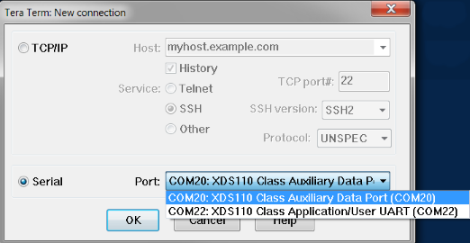

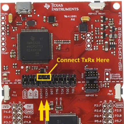

  • Armando,
     A couple of suggestions:
    1. Regarding Bruce's suggestion of routing P3.2/3 to a USB chip. You don't need a separate chip if you have an MSP432 LaunchPad.  The JTAG emulator built-in to the board also provides a backchannel UART through its USB cable .  You'll need to remove the existing jumpers on J101's RXD and TXD pins and connect your P3.2/3 to the pins (in the yellow box in the picture below)
      1. Once properly connected, you can use a terminal emulator (like TeraTerm) to connect to the appropriate COM port. See the picture below and select the "Application/User UART"
    2. An alternative is to directly connect the LaunchPad's RXD/TXD pins (in the yellow box) to your Bluetooth board and see if they function correctly when driven in this way.
    Hope that helps.
