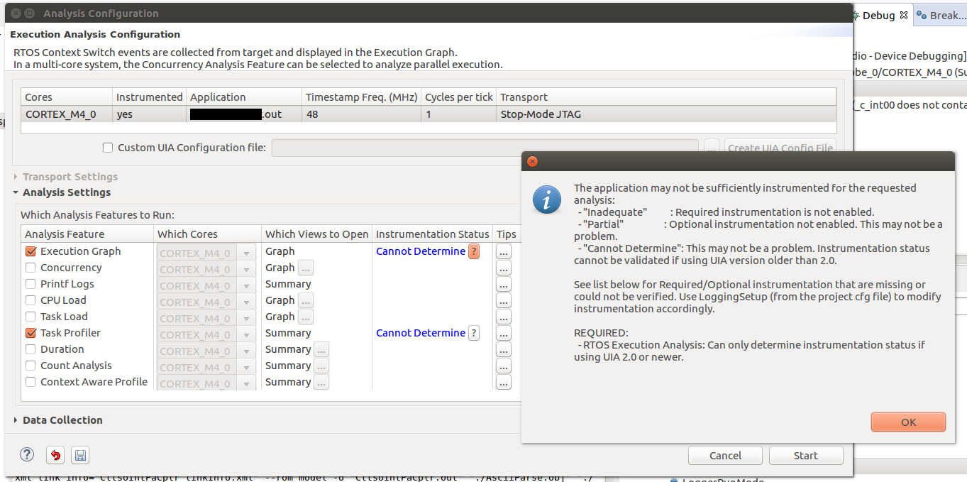

RTOS/SIMPLELINK-MSP432-SDK: RTOS Analysis - Instrumentation Status: Cannot Determine
Part Number: SIMPLELINK-MSP432-SDK
Other Parts Discussed in Thread: SYSBIOS
Tool/software: TI-RTOS
I"m trying to enable RTOS analysis to view the execution graph, however the Execution analysis Configuration is reporting "Cannot Determine" under Instrumentation status.
I'm running the follwoing:
  • Code Composer Studio 7.3.0.00019
  • ARM Compiler: TI v 17.9.0.STS
  • Target Board: LaunchPad Simplelink MSP432 (P401R) Red Board
  • XDCTools 3.50.5.12
  • Simplelink MSP432p4sdk 2.10.0.14

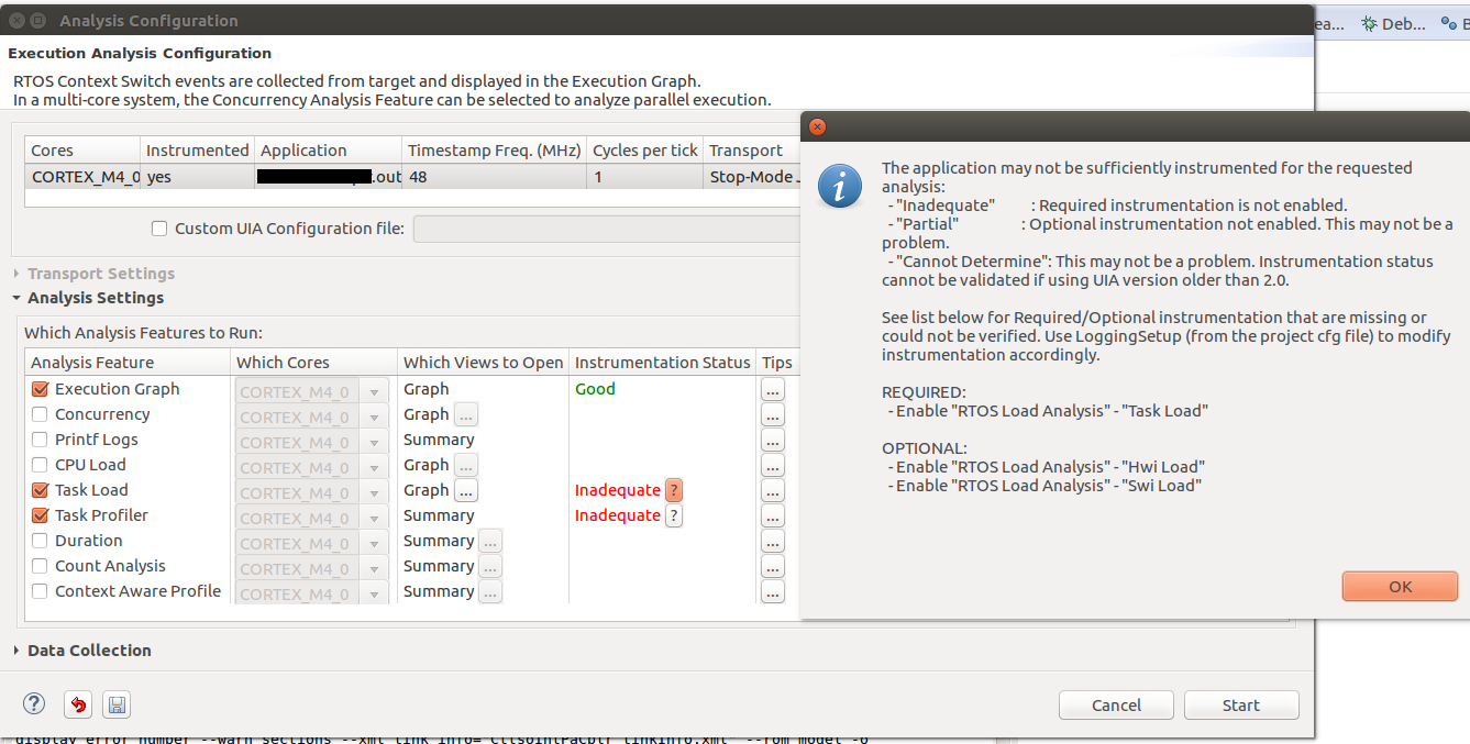

  • i've attempted to add (System Analyzer (UIA Target) 2.20.0.02, but that did not resolve the issue, and the simplink documentation seemed to indicate UIA is already enabled
If I click on the "TIPS" I get the message: " RTOS Execution Analysis: Can only determine instrumentation status if using UIA 2.0 or newer"
As you can see, I attempted to add UIA 2.20.0.02 (below) but that did not resolve the issue.  Any troubleshooting suggestions?

Defaults.common$.diags_ANALYSIS = xdc.module("xdc.runtime.Diags").ALWAYS_ON;
  • Mark,
    I've forwarded this question on to our internal RTOS support to see what help they can provide.
    -Bob L.
  • Hi Mark,
    It looks like you don't have UIA logging enabled in your .cfg file.  Can you try adding the line:
    var LoggingSetup = xdc.useModule('ti.uia.sysbios.LoggingSetup');
    to your .cfg file?
    Janet
  • Thanks Janet...
    I'm having a similar problem with Task Load Analysis etc...However they are showing up as "Inadequate".
    Is there documentation somewhere on what .cfg script changes are needed to enable this stuff.  I may be missing the obvious, but I've been having a hard time finding this kind of information.

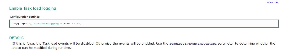

  • Hi Mark,
    It looks like you need to enable Task load logging in your .cfg file.  You can look at the uia cdoc under ti.uia.sysbios.LoggingSetup to see all the configuration parameters for LoggingSetup:
    You can add the line:
    LoggingSetup.loadTaskLogging = true;
    to your .cfg file.
    Janet
