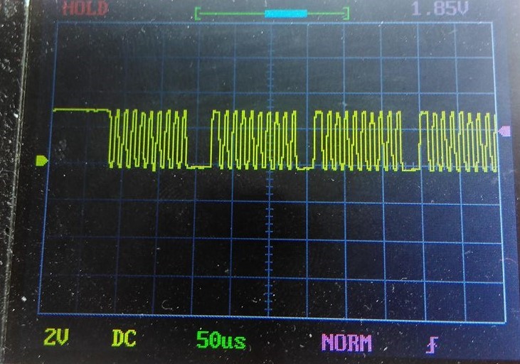

I'm struggeling with making i2c communication work properly. I'm working on MSP430F5529, I2C target device is DS2482-100 but right now I'm testing I2C communication on LCD (because I'm sure hardware connection and commands are fine, I got it working with MSP430G2452).
The code I'm running is:

This:
const unsigned char TxData[] = // Table of data to transmit
{ 0x78, 0xF1, 0x67, 0xC0, 0x40, 0x50, 0x2B, 0xEB, 0x81, 0x5F, 0x89, 0xAF };
are commands that should init LCD and set random pixels on it but nothing happens.
I only have single channel osciloscope, these are readings of SDA and SCL lines:
Time laps differ for SDA (50us) and SCL(20us).
What am I doing wrong?
