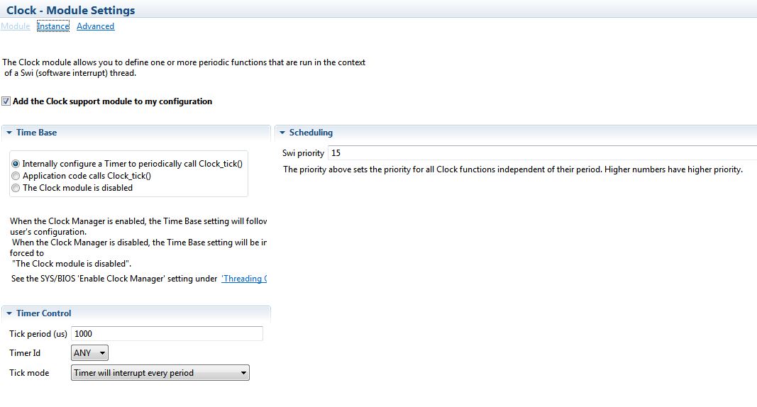

Hi team,
We are using the MSP432P4111 in our design and noticed that the RTOS by default enables the system tick. We are using XGCONF to configure our .cfg file and are wondering if we uncheck the "Add the Clock support module..." box below, will that disable the system tick? If not, is there another way to disable the system tick using this tool?

  • Hi Bob,
    We are interested in disabling the System Tick as we only need to wake up the MCU when an interrupt occurs. All of our tasks are spent in a blocking state until an interrupt occurs to wake them up to perform whatever needs to be done.
    Akash
  • Akash,
     I would refer to the following docs:
    1. TI-RTOS SimpleLink Timers
    2. TI-RTOS Kernel User's Guide (Section 5.1,5.2)
    In section 5.2 of reference (2), you can see that APIs are provided (Clock_tickStop() and Clock_tickStart()). You can also set the tickSource to Clock.TickSource_USER and manage the clock tick yourself. For what you want to do (temporarily disabling the system tick, you could use Clock_tickStop(), go to sleep, and use another timer (i.e. the RTC, to wake up after a specified interval). Section 5.2 gives some examples of how to manage clocks in this way.
