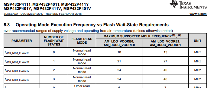

Another question is how to set flash wait states at 48MHz. From theory it should be 3 because the flash works with 16MHz. But I read the last page from "MSP432 Online Training Series  - Part 4". There you can see the setup with 2 flash wait states.
Is it working with 2?

    To my second question from above: Do you also agree that it must be set to flash wait state = 3 instead of 2?
    Thank you very much!
  • Yes, It must be 3 if the frequency is greater than 40Mhz. Please refer to section 5.8 of the datasheet for the cutoff frequencies for each wait state setting.
    www.ti.com/.../msp432p4111.pdf
    Chris
