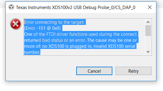

MSP432 Device on board is not detected by the JTAG programmer. This issue is seen only in couple of boards . Also there is no hardware issue and we see some activity in TDO output from the MSP432 part.
Is the JTAG port got disabled and is there any option to factory reset the part ?

Instructions for factory resetting your MSP432 device are covered in the Section 8 for MSP432 User's Guide (SLAU575):

I've the new MSP-FET-432 ADPTR . MSP-FET debugger which is not listed in the target configurations . Not sure what debugger I've to choose . I've upgraded to CCS8.1 and still my debugger is not listed in target configurations
