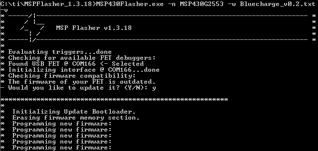

    I have already tried this, but no success - see results below:
    New MSP-FET device using latest flasher:
    I have also tried using the current MSP-FET430UIF device using the latest flasher (still no success):

  •  Hello Ryan,
    First, the connections should look like the image below taken from the MSP Hardware User Guide (http;//www.ti.com/lit/slau278 ) Basically, the TCK connection is not needed here for SBW comms unless you are blowing the e-fuse to lock JTAg. Int hat case, ti is not connected to TCK on the device, but as shown in the image.
    Second, from your capture above, it looks like the program was downloaded to the device but is having trouble verifying the memory. Have you tested your program to test for correct behavior, or tried to debug it see if its downloaded correctly? You could also just read out the Flash via CCS/IAR/Elprotronic Lite Fet Pro430 SW.
    in most cases that verify cannot be done on MSp430G2xxx devices is due to the calibration data in Info mem. If its not accounted for in images or accidently blown away in the middle of programming, this error can occur.
