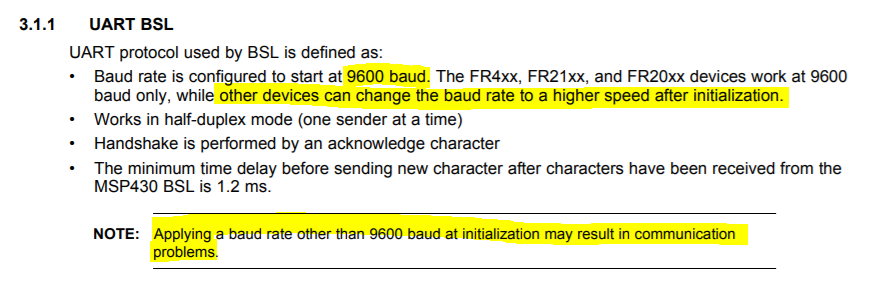

    One final note I'd like to make - you are going to want to double check that any peripherals that the FR2355 BSL uses (clock system, eUSCI_A, and TIMER_B) are cleared out before you invoke the BSL. Everything seems to be working, but I wanted to mention this in case your application code touches any of these peripherals before a BSL invocation is attempted. Please see below:
    This means you are going to want to make sure the following conditions are met before SW BSL invocation:
    1. The clock is at or below 8MHz (which you are doing)
    2. eUSCI_A registers are cleared
    3. TIMER_B registers are cleared
    Since you "set the clock to 1MHz without changing the UART settings..." conditions 1 is met. Please double check that the eUSCI_A registers and TIMER_B registers are cleared.
    UART must also be configured at 9600 baud before BSL invocation. You are already doing this, but I wanted to highlight this in my post for completeness:
    Thanks and congrats!
