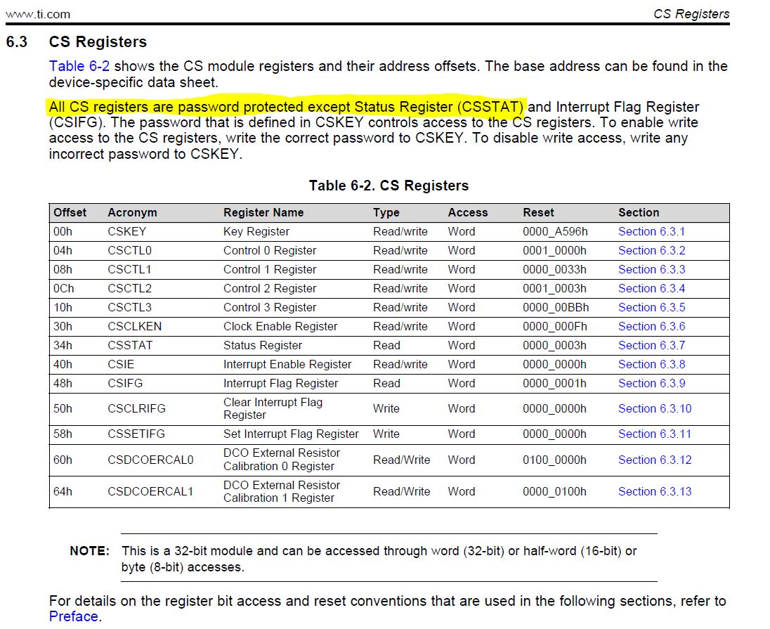

  • I would confirm that the device is operating at the speed you intend.  Since you did not unlock the Clock System control registers, I assume the device is running at 3Mhz and not 12Mhz.  If you are still experiencing overruns then you can either increase the MCLK speed so that the ISR is executed faster or you could incorporate a DMA and service after receiving a number of SPI transfers.
        CS->KEY = CS_KEY_VAL;                   // Unlock CS module for register access
        // Select ACLK = REFO, SMCLK = MCLK = DCO
        CS->CTL1 = CS_CTL1_SELA_2 | CS_CTL1_SELS_3 | CS_CTL1_SELM_3;
        CS->KEY = 0;                            // Lock CS module from unintended accesses
    taken from this example:
    Other examples:
    Chris

       I would recommend that you try and understand the password protection.  Please refer to page 393 of the TRM.
    The attempts to write to Clock System registers after you have locked the Clock System will not be applied.
    Chris
