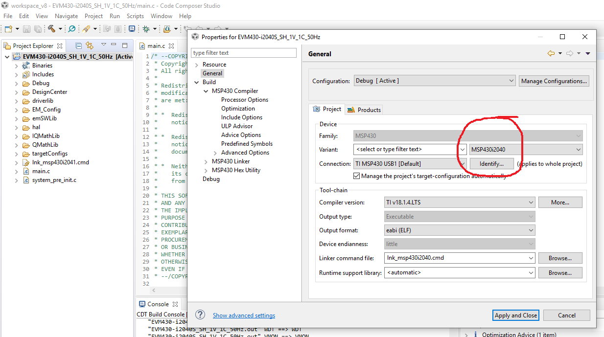

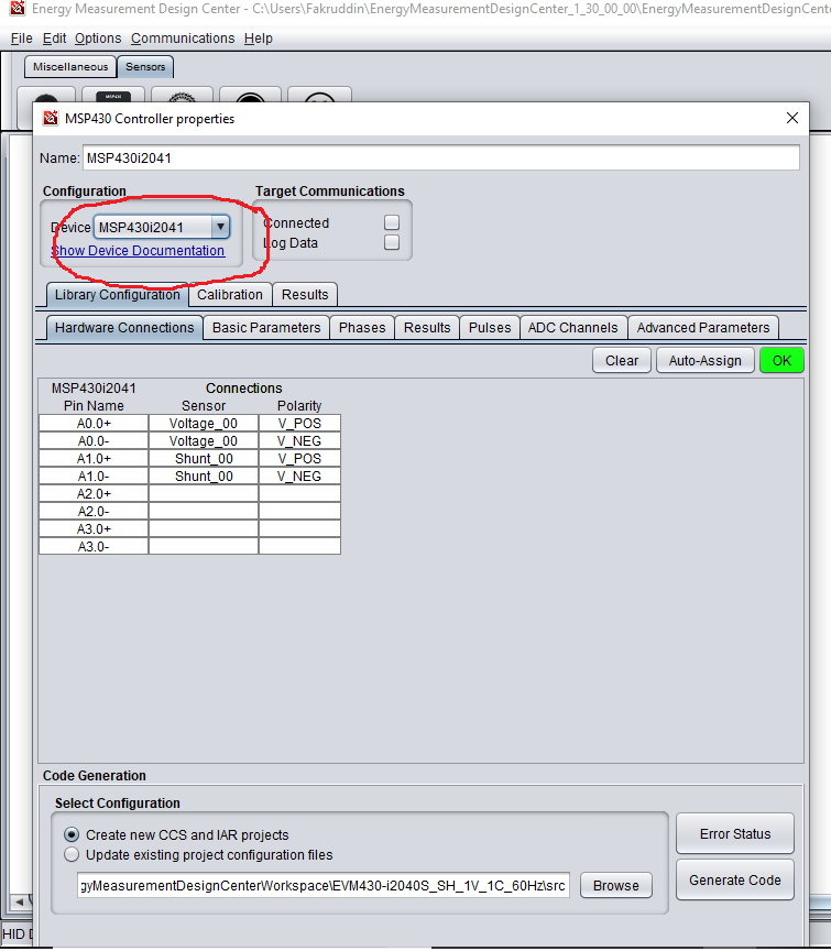

I have generated code from Energy Measurement Design Center (example project with MSP430I2041) just to flash code on MSP430I2040.

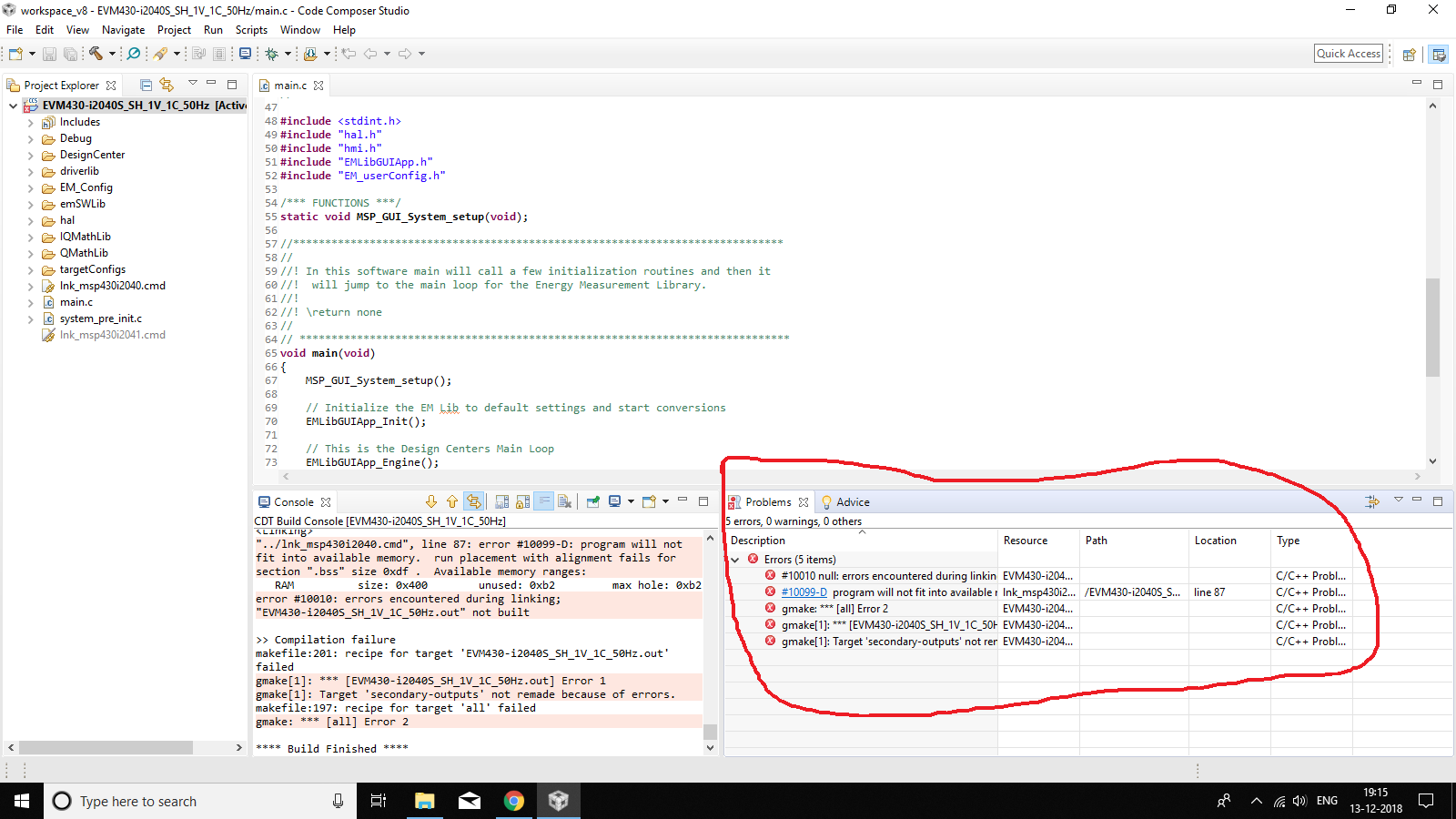

I imported code in CCS and changed the target from MSP430I2041 to MSP430I2040. But while building the code i am getting the errors.
How to generate code in Energy Measurement Design Center for MSP430I2040 or Is there any way by which we can generate code for this ?
