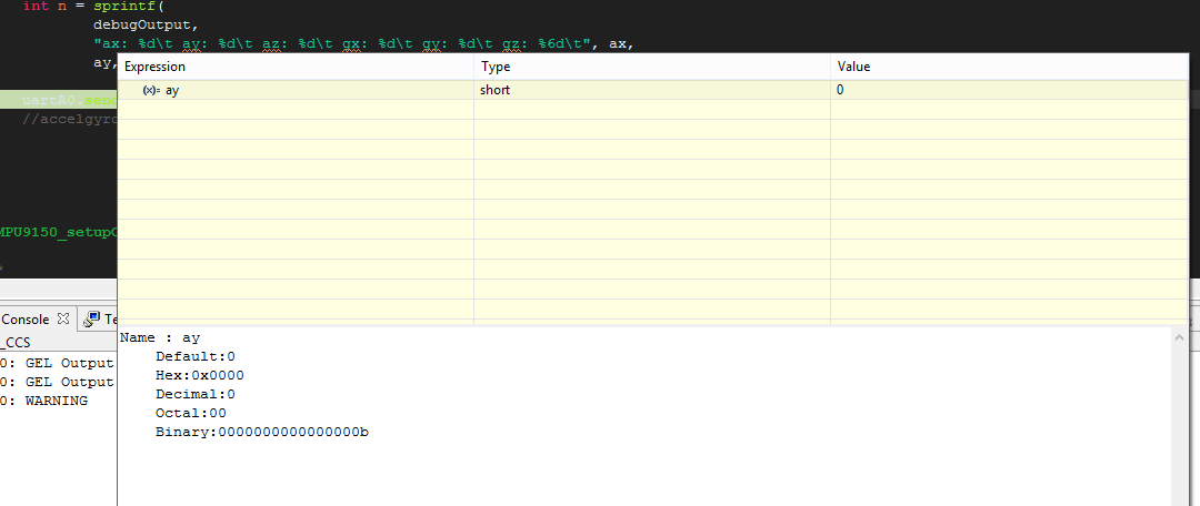

  • Hello Bruce, sorry about the late...
    Yes I'm receiving all-0s. FIGURE 1.

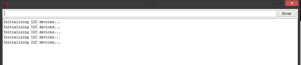

    I'm using the code from Malcolm Williams. When I tried to compile the code it didn't work (FIGURE 2.). Link of GitHub of Williams code.

  • I don't see any code in main() which fills in any of ax/ay/az, since this:
    >//accelgyro.getMotion6(&ax, &ay, &az, &gx, &gy, &gz);
    is commented out, so they will be =0 forever.
    I suppose you could try un-commenting it, but since it was commented in the original, I'm wondering if the code you started with is not-quite-finished.
    Also, it looks as though getMotion6 ends up calling readBytes, but that function is empty (no code at all).
    Getting this code to work may be more difficult than you perhaps intended. Did you find any other samples?
  • I ran the code, without the comment bars, and the result was the same.
    I thought the same thing. Probably the code wasn't finished yet, because the first time I tried to run the code I found some bugs.
    I found another sample (LINK), using Energia IDE, and it uses the same libraries of Williams's code. But it didn't work (FIGURE 1).
    Now I think that my I2C's pins may have a problem. I have an MSP430 and I'll try to establish a connection with MSP430 and MSP432 via I2C, to discard this possibility.
