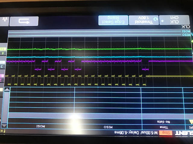

I am using the MSP430FR5994 Launchpad and am unable to generate the CS (STE) using the DriverLib and EUSCI_B1 (SPI is in the primary module). I can produce the clock and MOSI signals, just not the STE. Below is a scope image, followed the SPI setup configuration snippet and finally followed by a simple loop in the next snippet.
Scope Image. Signals listed from top (yellow) to bottom (green) are SCLK, MOSI, MISO, #CS (notice it is always high)
I am using Mode 0 which samples data on the first transition of the clock. The interface for UCB1 are P5.0 (SIMO), P5.1 (SOMI), P5.2(SCLK) and P5.3I(STE).

The simple loop I am running (captured on the scope) is below. A couple of notes:  I lifted most of the code from the OUT-OF-BOX example for my test. In that example, the CS was coded separately (it did not use the built in STE) and for some reason chose to use EUSCI_B_SPI_3PIN mode. My understanding is that 3PIN mode multiplexes SIMO/SOMI onto one physical wire. The SD card has separate SIMO and SOMI pins so why he did this I don't know.  Anyone know? I am wondering if STE did not work in 3PIN mode which is why he coded his own..... if so isn't this an errata?
