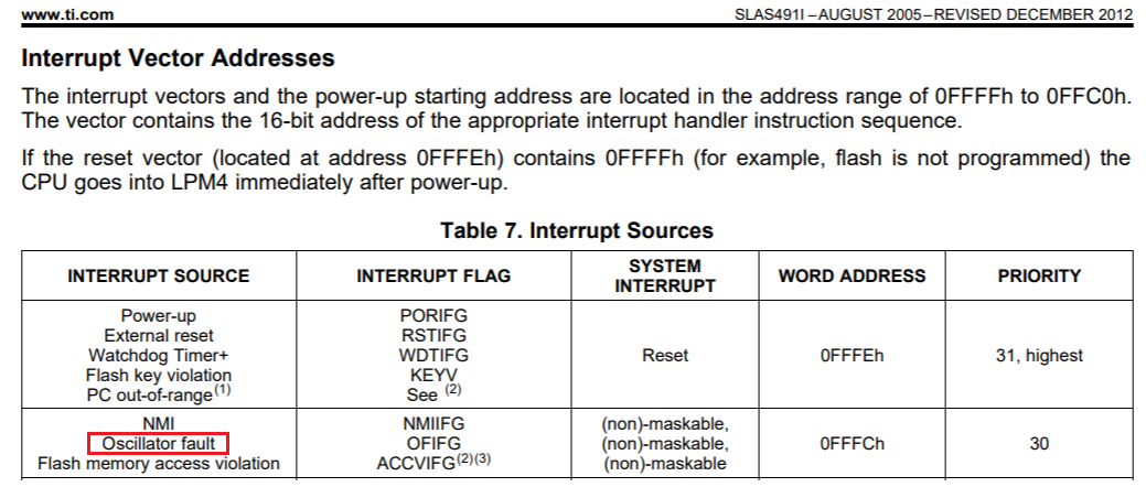

MSP430F2001: What's the MSP430F2001 status if oscillator fault happen?
The OFIFG oscillator-fault interrupt flag is set and latched at POR or when any oscillator fault (XT1OFFG or DCOFFG) is detected. For more information you can refer to the user's guide 3.2.13 www.ti.com/.../slau445i.pdf
