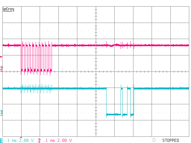

The ROM Bootloader on our MSP432E401Y based target system is being invoked through a HW pin or an empty application flash. This seems to work as expected. However after sending the the autobaud characters (0x55 twice), we get a strange ACK sequence that is being preceded with a 0x00 character. At the moment I am not sure if the baudrate detection algo has a problem or the documentation is not the correct one (SLAU746A)? Any hint or help on how to continue would be appreciated. We are not using BSL Rocket in between. We use a USB-to-Serial cable instead. Is this a problem?
br
Markus
Magenta is the signal measured on the IO PIN UART0 Rx (Input)
Blue is the signal measured on the IO Pin UART0 Tx (Output). The response looks like 0x00 0xCC (an ACK with 0x00 preceded?)

  • Some more info for Sai,
    I did check the examples in the SDK and yes it shall xmit two octets, the first being 0x00, then the ACK (0xCC). Therefore there is nothing special about it. What is special is the fact, that the answer from the target is not being notified within the UniFlash tool. However the answer is being sent and can be scoped and can be received using another terminal program. Therefore I assume the 'magic' has to do with the UniFlash utility. I am using the version 5.1.0.2397. There is maybe another version that has to be used on the W10 host together with the MSP432E01Y.

    thank you for doing the testing. However it does not work. As I did point out in various of my previous posts. I do get the response from the target after the autobaud command. The target is the MSP432E401Y. The BSL-Scripter Tool is saying "No response bytes received from BSL!". When I '"mimic" the behavior of the Scripter-Tool with a terminal program that is able to send binary characters for autobaud recognition the terminal program is able to receive the response from the target. Therefore the signal chain is operating correctly. For the time being I have no idea of what to do next besides starting to debug the BSL-Scripter Source on the PC ...
  • Hi Markus,
    when we send the auto baud rate, the BSL will replay with 0x00 0xCC. I haven't tried the hardware invoke on my end, but the empty device should invoke the bootloader when you power cycle / reset the device.

  • Hi Markus,
    apologized for late response. There are couple of things to be clarified here, this might be a bit long to follow :)
    1. When we are using the ROM bootloader, the automatic baud rate is always activated. Therefore the sync-byte should be sent. Host sends the 0x55 0x55 and the target device bootloader replies with 0x00 0xCC. What shown in your oscilloscope screenshot is excepted.
    2. However, I found the limitation on BSL Scripter side. When the software is updated, we combined the use with the communication bridge what so called "MSP-BSL Rocket". Since the Rocket supports not only the MSP432PE4 but also MSP430 and MSP432P4. If you take a look into the UartCommE4xx::init() function, BSL Scripter will initialize the baud rate with : (chosen baud rate + 8). This special baud rate is generated so that Rocket knows that it works with E4 devices. Why? Because to work with other MSP430 devices, Rocket has to generate special hardware invocation through other pins. the problem that we saw--which I could reproduce here, mostly caused by the (chosen baud rate + 8) and when it switch to the actual communication baud rate, might be the sync byte 0x55 0x55 is not sent with precise speed.
    3. If you would like to use BSL Scripter, I found a simple workaround that you need to add on the script:
      MODE E4xx COM28 UART 115200
      DELAY 1000 // 1 second delay, shorter could work too, the unit is in milliseconds
      RX_DATA_BLOCK_32 boot_uart_flash_MSP-EXP432E401Y.txt
      the delay will give some time for BSL Scripter has enough time to switch from (baudrate+8) to be the actual baudrate
