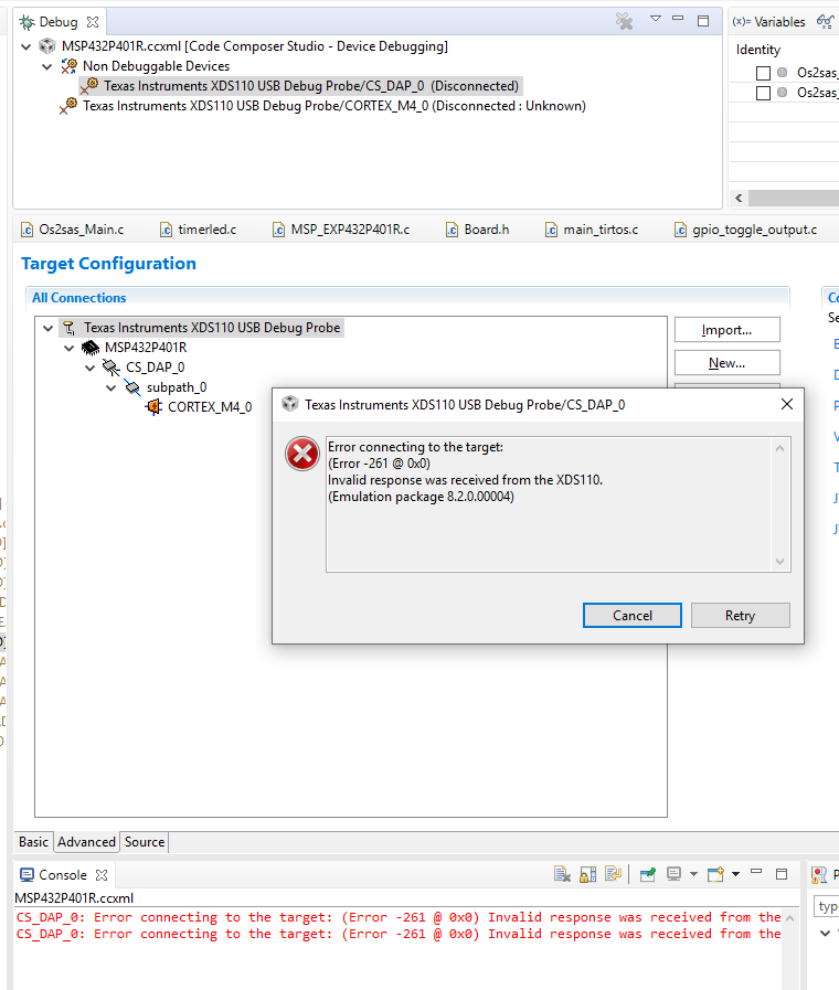

At this point the board cannot be factory reset by the standard procedure. Once you select the Target Configuration (Launch selected configuration) -> show all cores and then select "Connect", you get the following error:

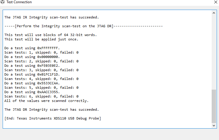

However, when you test the JTAG connection via target configuration, the JTAG integrity test succeeds which means the XDS110 still sees the MSP432.

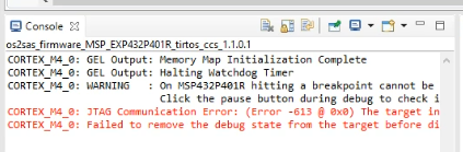

I have attached a simplified version of the timerled_MSP_EXP432P401R_tirtos_ccs project which contains the Board.h file you requested. When programming the board with this simple example, I set some breakpoints while testing a new board and our custom board did not make it past line 64 in main_tirtos.c which pinpoints the error to Power_init():
Board_init();
The following error occurred:
CORTEX_M4_0: GEL Output: Memory Map Initialization Complete CORTEX_M4_0: GEL Output: Halting Watchdog Timer CORTEX_M4_0: WARNING : On MSP432P401R hitting a breakpoint cannot be detected by the debugger when the device is in low power mode. Click the pause button during debug to check if the device is held at the breakpoint. CORTEX_M4_0: JTAG Communication Error: (Error -613 @ 0x0) The target indicates that it is busy. Either try the SWD request again, or abort the transaction. (Emulation package 8.1.0.00005) CORTEX_M4_0: Failed to remove the debug state from the target before disconnecting. There may still be breakpoint op-codes embedded in program memory. It is recommended that you reset the emulator before you connect and reload your program before you continue debugging
Screenshot also attached:

After step 7, we are still able to successfully run Test Connection (in both JTAG/SWD Modes)
At step 8 (Connect only to the Non-Debuggable Devices > DAP) we get the following error after selecting Connect Target
This is strange because the XDS110 can see the MSP432 JTAG but cannot program the board.
