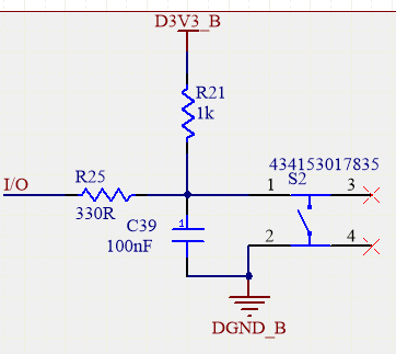

I would like to use a msp430f6638 mcu and connect to an I/O pin a push button. After checking the datasheet of the F6638, I didn't really find the high and low logic voltage for this mcu. All I found is about Schmitt trigger. In fact I guess this is important to determine the maximum pullup resistor value to connect with the push button. Here is below my scheme.
I don't know if 1k is enough or maybe too high. The problem is that with this F6638 mcu I don't know what maximal pullup resistor to choose so the F6638 could interpret a high logic level (DV3_B = 3.3 V in my case).
PS :Also just to be sure, I have a doubt for this : the 1k resistor above, could be connect to the DVCC of the F6638 (which has its decoupling caps) or the push button should have its proper decoupling caps ?

  • Hi Mike,
    The specs of  Schmitt trigger are the specs of digital input. Actually, the structure of a pin as digital input is a Schmitt trigger. But we only have the test data for 1.8V/3.3V DVCC.

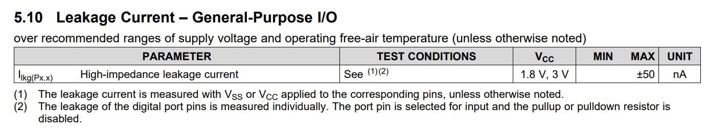

    The maximum leakage current of a pin is 50nA, so the voltage apply at the pin through a 1k pullup resistor is (3.3V - 50nA*1Kohm). According to the voltage dropout, the 1k doesn't over the maximum. But the current consumption may increase by 3.3V/1k = 3.3mA when pushing the button. You may consider this influence.
    The internal pullup resistor is between 20-50kohm, you can refer to this value.
    It's better to have a own decap closing to the button.

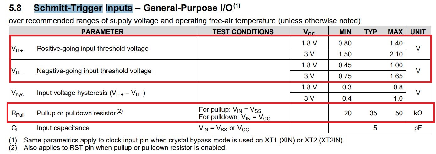

    Thank you very much for your answer. So according to table 5.8 all my I/O inputs should not be higher than 2.10 V  for high logic level ? This means that if I have a 3.3 V and 0 V external logic signal this will not work because of the 2.10 V max threshold and 0.75 V min threshold ? In others words if I have a 3.3 V input ( >2.10 V) then the F6638 wouldn't be able to recognize a high level logic input ? Same, if I have a input voltage lower than 0.75 V ? If yes this is problematic, how should I deal with that ?
    Also, the datasheet talks about 1.8 and 3 V. Then what are the logic levels for 3.3 V ?
    Finally, I'm using an external pullup resistor as you have seen it in the scheme above, and not the internal one. Should the external pullup resistor be in the 20-50 kohms range ?

    The max 2.10V doesn't mean all I/O inputs should not higher than that value. It means the high logic voltage varies from 1.50V to 2.10V for different devices for 3.0V DVCC. To handle the difference between devices, you should ensure all I/O inputs higher than 2.10V for high logic level. Conversely, for low logic level, ensure all I/O inputs lower than the 0.75V, minimum value of VIT-.
    We don't have test data at 3.3V power supply.
    Use external pullup resistor with value in the range of internal one is OK.

    Thank you for your response. I don't understand then why there is a range. I mean if we should ensure that all I/O inputs are higer than 2.10 V for high logic level, this means in the datasheet we should have something like 2.10 V is the minimum input voltage to get high logic level and not that 2.10 is a max value. I mean I didn't understand this 1.50 and 2.10 V range. Is this the range for the MSP430F663X family ?

    Yes, the meaning of that data may let user confuse. But, this range doesn't mean the range for high logic level for a single device. It means you test a certain amount of devices, and get a varied high logic level for each one. The range is for these devices. So to get high logic in all of your boards in mass production, you should give a  voltage higher than 2.10V.
