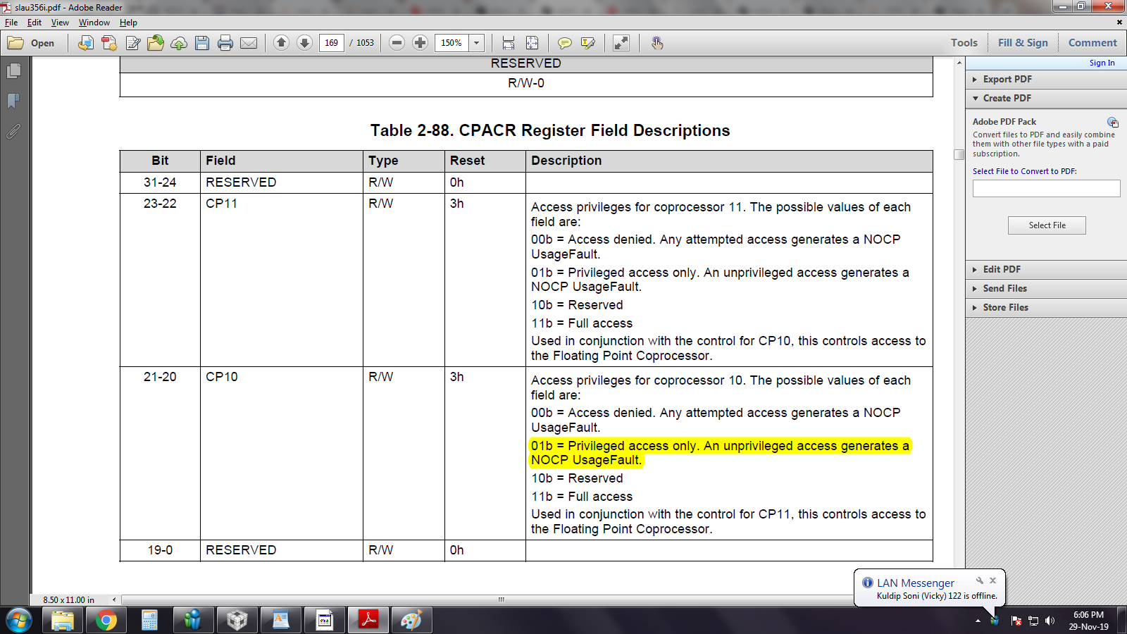

As shown in the picture my code jumps to FaultISR every time From one instruction and that instruction is
if (i < j)
     tx = ArrayA[i];             // and that line is this from which it evry time jumps to FaultISR.
     ArrayA[i] = ArrayA[j];
     ArrayA[j] = tx;
 after shifting to FaultISR these bits are set as shown in figure... How to solve this problem.
  • Photograph given shows CP10 bit which is also set at FaultISR which shows
    unprivileged access generates a
    NOCP UsageFault.
  • My first guess is that ArrayA is floating point, and the FPU isn't turned on. It's normally enabled in SystemInit (the source is in your project) as 0x00f00000, based on __FPU_USED. Check the project to see if -D__FPU_USED=1 is set. There's also a project setting (Build Settings->Compiler->Processor->Floating point) which may figure in here somewhere.
    I don't see CPACR in your screenshot. If it's really set to 0x00100000, that's rather unusual, since the reset value is 0 [Ref DUI0553A Table 4-49] and SystemInit doesn't set it to that either.
    In any case, there's nothing wrong with your main() enabling the FPU explicitly (copied from system_msp432p401r.c):
    >SCB->CPACR |= ((3UL << 10 * 2) | (3UL << 11 * 2)); // Enable FPU
    If ArrayA isn't floating point, my next guess is that you've misspelled an ISR name.
    [Edit: Fixed reference]
  • Adding this line to clock routine just solved my problem.... thank you so much Bruce Mckenney47378   :)
  • I'm glad it worked out. This is how we did it back in the Ancient Days. I think there's a mechanism that is supposed to do this auto-magically now, but I never had the patience to figure out how it worked.
