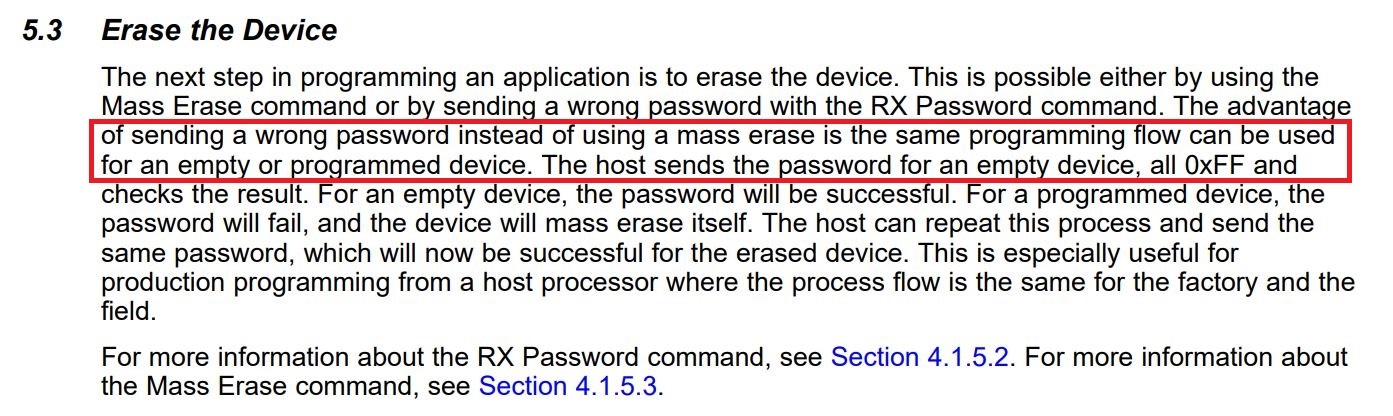

customer wants to mass erase the flash over BSL. But it doesn't work, he not getting any ACK after he send the mass erase command. He can access the BSL and programming is also working.
