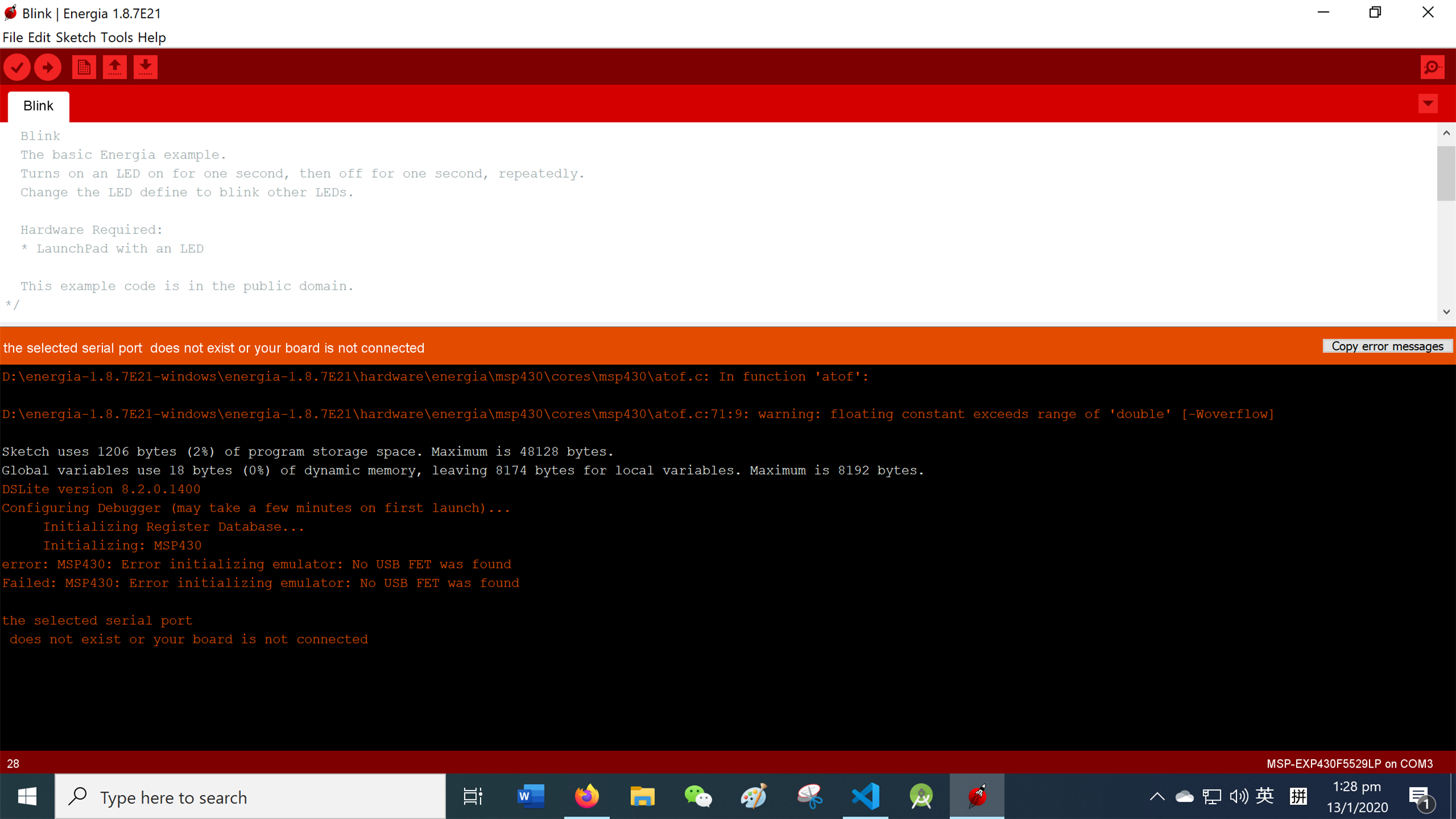

I used this board in Energia, 1.8.7.E21, when I try to upload the "Blink" example, it shows:
Is here anyone has also met with this error ?
is the launchpad in general recognized on your machine (check system manager)?

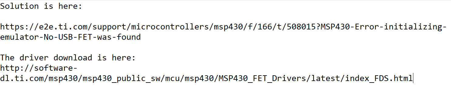

So does it mean the USB FET issue is resolved and now you are not able get the LED example running?
Was programming and verification successful if yes you maybe have to power cycle the board.
Yah, you are right, it's OK. While, last night, I also operated this way, it didn't work, I don't know why.
Great to hear that it is resolved good luck with further working on MSP430. If you have any question please contact the forum.
