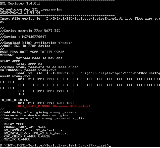

  • Hi
    I tried with BSL-scripter application but MCU gives me "Header  incorrect!" error. (verbose mode on)
    Let's forget BSL-scripter.exe and turn to my GUI.

    I wonder that while my application runs succesfully on MSPFR6989 device, why does't run with MSPFR6047?
  • I resolved BSL-stricpter's "header incorrect" problem writing PARITY to MODE line in script input file.
    But result is same. BSL is not responsive to any command after mass erasing performed.

    I sow your input in your CMD file is wrong if you capture all your CMD window above.
    You can follow the guide attached 2262.Download_image_BSL.pdf
  • Hi.
    I just renamed script_FRxx_uart.txt as s.txt for writing simplifed.
    Originally, file is script_FRxx_uart.txt
