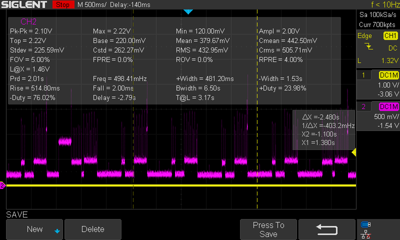

We've ported an MSP430 based application to the MSP432 and we're having an issue with power consumption on the MSP432, despite using LPM3 in our idle task, as we did on the MSP430.  The code is almost identical between the two platforms, with obvious differences between the driverlib APIs.  Both processors have similar peripherals, and both are running at 8 MHz.  All pins are properly terminated or set to output low to minimize power.
The two traces below show the comparison in power draw in real time, where the MSP432 draws approximately 1.44 mA, while the MSP430 draws approximately 0.84 mA.  The stepped up higher levels represent the power draw of the sensors, which are turned on and off.
We were under the impression that the MSP432 would draw comparable or less current than the MSP430 did, but this shows an increase of 0.6 mA, which is a show stopper for our low power requirements.  If we can't get the power down we may be dead in the water.
We have our own task scheduler which puts the system into LPM3 mode when idle until an interrupt occurs, at which point the system goes back into active mode, services the interrupt, then whatever task is associated with the event that caused the interrupt, then goes back into LPM3.  A GPIO output pin was used to monitor the relative time the system is in LPM3, which is probably around 99%.
There was a difference of around 0.7 mA if I removed the call to go to LPM3, so it looks like LPM3 is working.
Any ideas on why the MSP432 is drawing so much more current than the MSP430?  It seems like if we could get the lower level of the trace on the MSP432 to match that of the MSP430, we would be good to go.

MSP432 Power Draw
MSP430 Power Draw

    What you see in the scope trace appears to be a voltage waveform when in fact it's a current waveform, the output of a current sensor that's fed into the scope with a conversion factor from volts to amps.  At the moment I'm not as concerned about the absolute numbers as I am about the comparison between the MSP430 and the MSP432.  If we can get the MSP432 current profile to match that of the MSP430 we're good.  If not, this effort to migrate from the MSP430 to the MSP432 may be a waste of time.
    The waveforms below show the on-time of LPM3 mode and a transition from LPM3 to give you an appreciation for how much time we're spending in LPM3, and the effect switching out of LPM3 has on the current.
    LPM3 On-Time (yellow trace)
    LPM3 transition showing the effect of momentarily disabling LPM3

  • The ratio is two to one, so 1 mV = 2 mA.  The last two plots seem high for some reason, but generally I'm getting somewhere in the neighborhood of 720 mV = 1.44 mA for a mean current draw on the MSP432, compared to 421 mV = 842 mA on the MSP430.  The difference in current draw is almost equal to the difference we're seeing if LPM3 is disabled, which is around 0.7 mA.

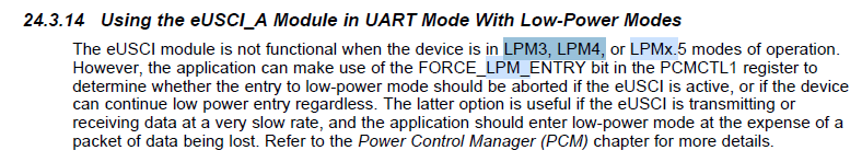

  • We seem to have found the smoking gun, but it doesn't make sense.  It seems that if we configure our UART clock sources to be EUSCI_A_UART_CLOCKSOURCE_ACLK instead of EUSCI_A_UART_CLOCKSOURCE_SMCLK we can get the power to go down, but this constrains us to a maximum baud rate of 9600, which is too low for our application.  in other words:
    eUSCI_UART_ConfigV1 param.selectClockSource= EUSCI_A_UART_CLOCKSOURCE_ACLK;  //consumes 680uA of current
    versus
    eUSCI_UART_ConfigV1 param.selectClockSource= EUSCI_A_UART_CLOCKSOURCE_SMCLK;  //consumes 1.4mA of current
    This is unexpected, because our SPI ports are sourced by SMCLK, and that doesn't prevent us from going into LPM3, so:
    eUSCI_SPI_MasterConfig param.selectClockSource = EUSCI_B_SPI_CLOCKSOURCE_SMCLK;  //goes into LPM3

    The UART in MSP432 doesn’t have start-edge detection to wake-up from LPMx like the MSP430. Newer ARM processors have implemented dedicated LP-UART modules, or some workarounds to be able to wake-up the UART because of this.
    When you enabled rude mode (disabled high-speed bus requests), the UART (which was requesting the bus) got disabled thus explaining the lower current consumption.
    One workaround for the UART you can try is using a GPIO to wake-up the device from LPMx and then doing the UART communication.

  • Thanks for the explanation.  We came to that conclusion as well that the UART wasn't waking up from LPM3 fast enough to service the interrupt.  We will try your workaround, which should work, because our application will permit lost packets while the port wakes up and configures itself to a higher baud rate.
    We were able to make the power go down to the original low level (680 uA) by clearing the Rx interrupt flag, disabling the interrupt, and disabling the UART prior to re-configuring it with ACLK as the source.
