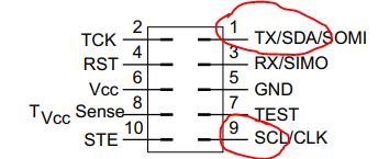

  • Thanks for the information. Regarding the I2C BSL, I plan to solder the resistors on the MSP-BSL PCB.

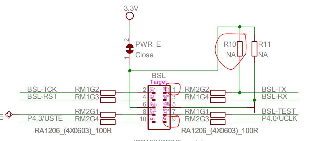

    So I should be connecting a pull up resistor to pins 1 and 9 on the MSP-BSL PCB. But in the bottom schematic I see R10 that I can add for the SDA line but I don't see any placeholder for the pin 9 SCL line. Please let me know if there is a way to add the pull up resistor to the SCL line on the MSP-BSL PCB.
  • Hello Swetha,
    What you're describing makes sense, but I think Olimex overlooked what pins are connected to those two pull-up resistors, R10 and R11.
    I downloaded the MSP-BSL source code and noticed that P4.5 (BSL-TX) is port-mapped to PM_UCB0SDA in the 'peripherals.c' file. Populating R10 would enable the I2C communication on that pin. However, in that same file, I noticed that P4.0 was port-mapped to PM_UCB0SCL. As you can see, R11 is connected to P4.4, not P4.0.

    One option would be to modify the source code and port-map P4.4 to PM_UCB0SCL and P4.0 to PM_NONE. This means that your target's SCL connection would be Pin 3 and not Pin 9. Then, you can populate R10 and R11 and everything should work correctly.
    A second option would be to add a resistor between the P4.0 and P4.1 pads on the bottom side of the MSP-BSL and configure the software to output a high on P4.1. This would pull up P4.0 and would allow you to use Pin 9 for your target's SCL connection.
    The third option would be to just solder a pull-up resistor to VCC somewhere on the board and connect it to P4.0.
    The last option would be to do the third option on your LaunchPad.
    Perhaps I'm missing something here, but I'll share this feedback with Olimex to see if this can be improved. I hope these options help.
